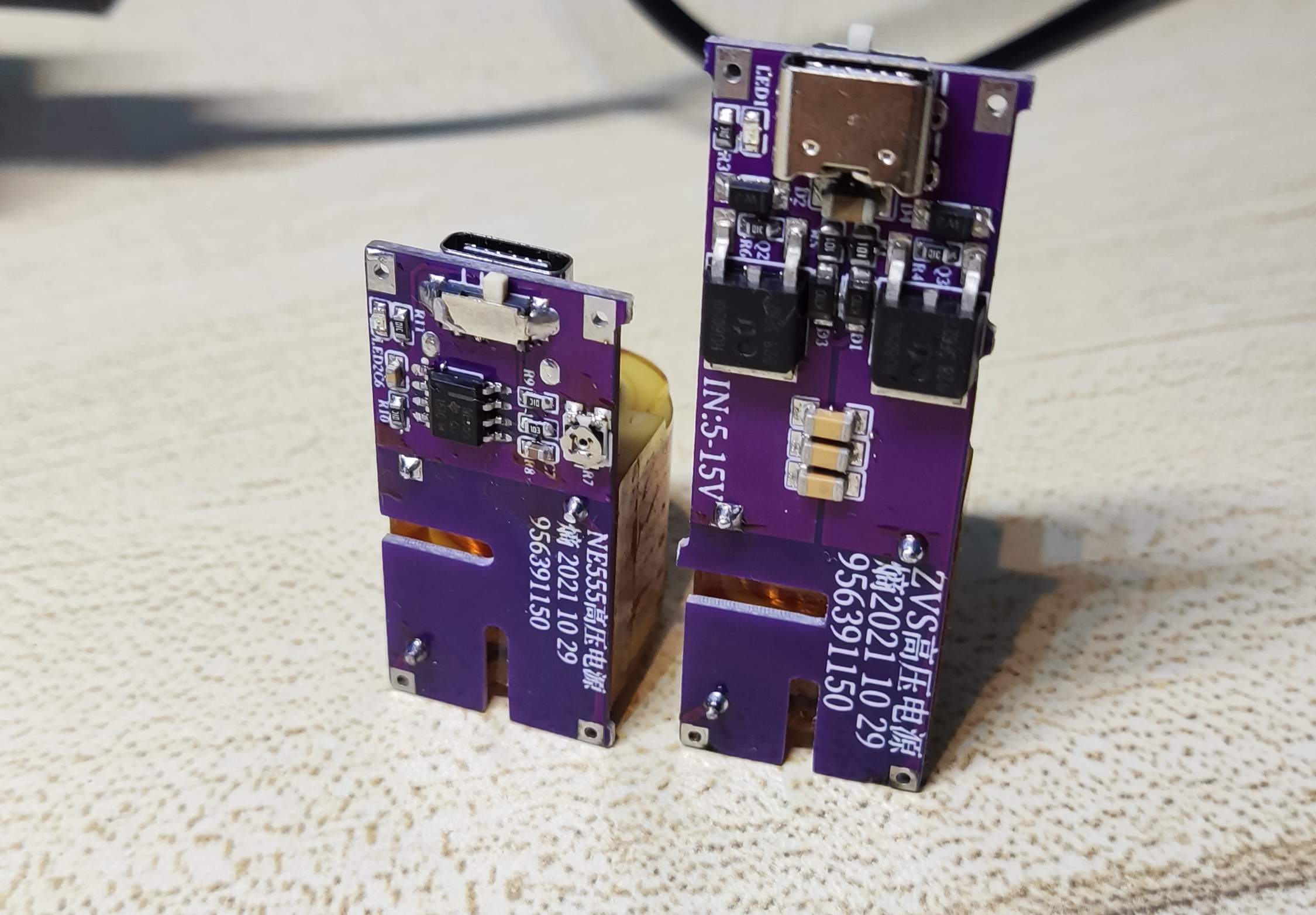

There are currently only two versions of this project. Lichuang EDA can only display one version at the same time. You need to switch manually if needed.
Version 1.0: Mini ZVS drives a small high-voltage package, input 5V, no-load current 0.35A, arc 5mm current 1.5A. The higher the input voltage, the greater the no-load current, the more severe the heating and the more intense the arcing. The 5V input visually outputs a voltage of about 1KV.
Version 2.0: NE555 driver MOS is driving a small high-voltage package, the input is 5V, the no-load current is 1A, it is not recommended for serious heating, and the arc current is 1.5A for 1mm. , 5V input visual output voltage of about 1KV
