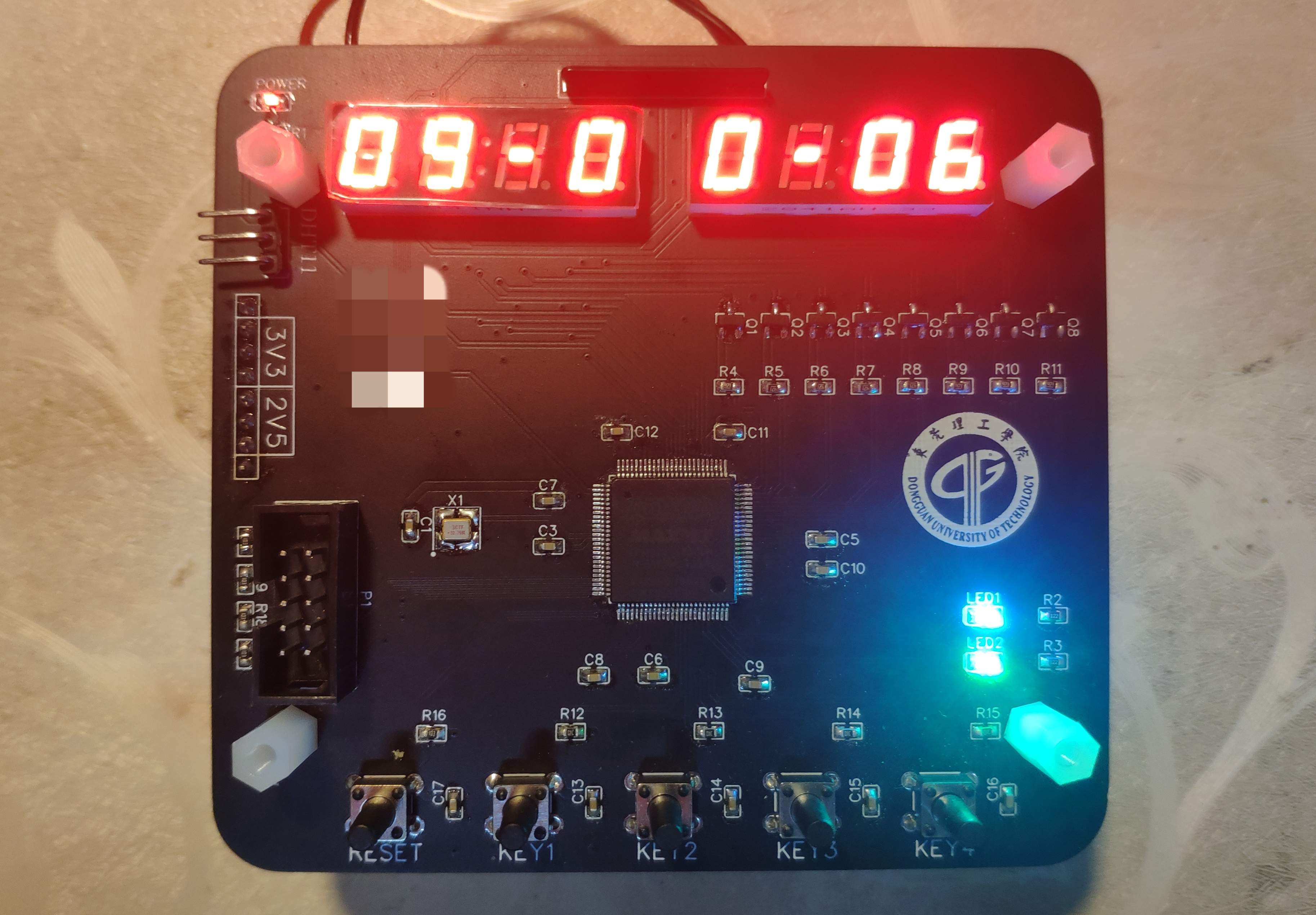

2. Main control board
Actually, there’s not much to say about this part. Some circuits refer to the FPGA development board of Zhengdian Atom. Just look at the schematic diagram
3. PCB display
Power Board
A lot of tantalum capacitors are used in the design of the power board, some of which can be deleted (after all, tantalum capacitors are not cheap)
Main control board
Notice! The four capacitors on the back do not need to be soldered, I just leave a place there. It is to prevent the power supply from being dirty, and it can also be remedied!
4. Finished product display
The mosaics on the PCB are the names of our team members. I have removed this part in the open source version.
