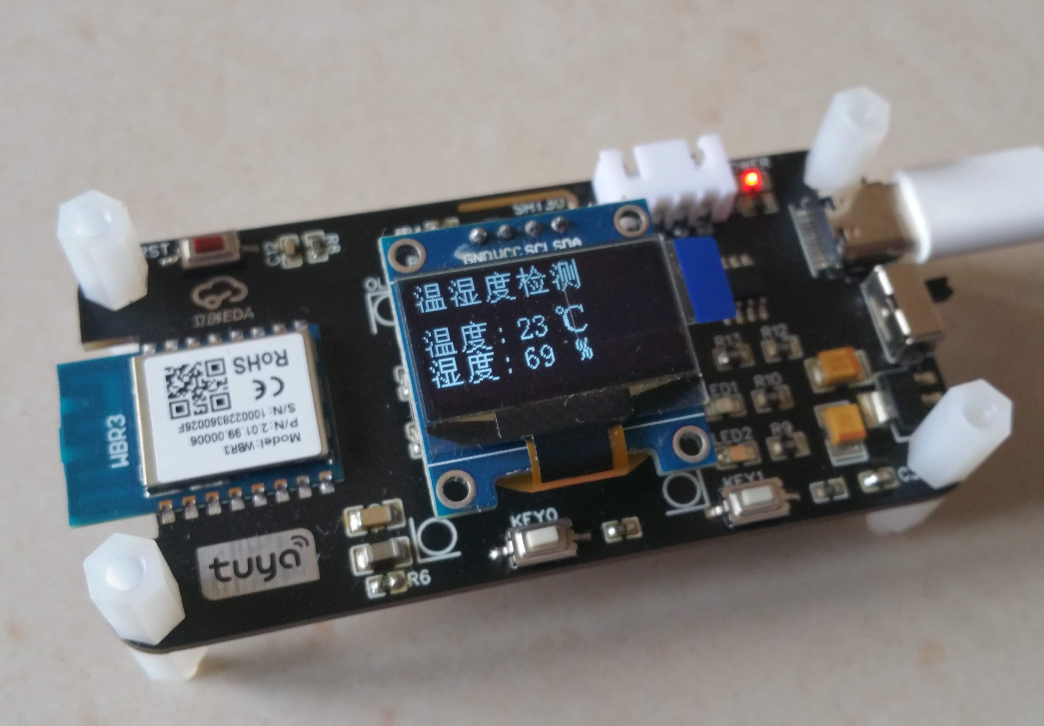

The IoT thermometer and hygrometer based on Tuya Smart automatically collects current temperature and humidity data, uploads it to the cloud through STM32 & Tuya IoT module, and displays it through the Tuya Smart APP.
1. Implement functions
2021.2.24:
  1. Get ambient temperature and humidity
  2. Display temperature and humidity information through OLED
  3. Transmit the obtained temperature and humidity information to the APP
  4. Set the network distribution mode with buttons

2. Hardware
1. MCU
The design uses STM32F103C8T6. Due to the outrageous price of STM32 recently, we switched to the domestic chip APM32F103C8T6.
2. Power supply
Use a USB-Type-C plug and a power switch; 5V to 3.3V, of course the AMS1117-3.3 that remains unchanged for thousands of years.
3. Networking module
Tuya's WB3S module has BLE & WIFI dual-mode, and the network configuration operation is very comfortable. This time I used the MCU SDK development method.
4. Temperature and humidity sensor
SHT30-DIS uses the IIC interface. This is my first time using this. It is said to have high precision, low power consumption, and is suitable for welding.Very friendlyI bought a heating plate specifically for this purpose, but it left a black mark on my coffee table... WeChat picture_20210301201828.png
The nRESET pin does not need to be connected, there is a pull-up inside the component.
5. Serial chip: CH340N
It is used for debugging and is connected to the Type-C port. A relatively small serial port chip is used. I feel that an onboard serial port chip looks more elegant than an external serial port cable. Both CH340N and CH330N are available. Don't forget there is a 0.1uF decoupling capacitor on the back. Back + arrow.jpg
6. Display
0.96-inch OLED screen with IIC interface.
7. Buttons
2021.2.24:
There are two function buttons, KEY0 is used to configure the network, and KEY1 is used to clear the network configuration (actually the functions of these two buttons are the same). No matter which button is pressed, LED2 will light up for a while and then go out automatically.
2021.3.6 update:
KEY0 is used to trigger SmartConfig, and KEY1 is used to switch the OLED display interface.

1. PCB
I made two boards. The welding on the first board was really bad. It was so ugly that I couldn’t stand it anymore, so I made a new one.
2. Initialization
3. Distribution & Networking
4. Temperature and humidity display
