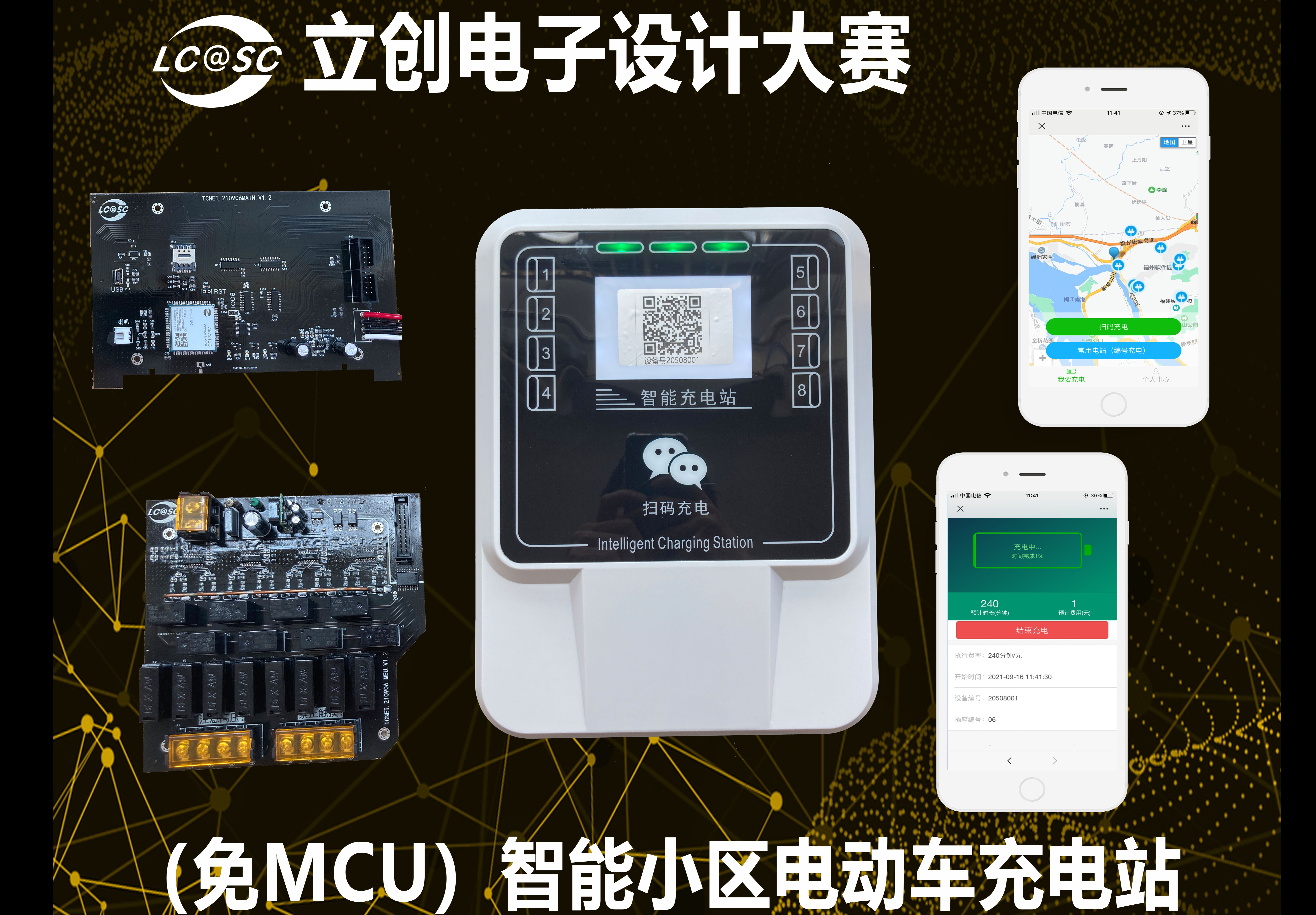

# Sixth Lichuang Electric Competition# Intelligent Community Electric Vehicle Charging Station
* 1. Introduction to project functions
Due to the recent rise in the price of microcontrollers, many products cannot afford microcontrollers. They used to use ST microcontrollers, but now they can only use domestic ones. The entry this time was developed from the 4G module of the LUAT open source platform. This module can have I2C , USART, SPI, voice, etc., can completely replace the role of the microcontroller in the charging station. Currently, there is no implementation case using this solution on the entire network, so I chose to try it.
Function introduction
  1. Self-stop when full: avoid overcharging and protect charging safety.
  2. No-load power outage: When the charging station is not in working condition, the socket station is not powered.
  3. Overload protection: When the power exceeds 500W, the circuit automatically cuts off power. The maximum power can be set independently, with a maximum support of 2000W.
  4. Overvoltage protection: When the grid voltage is higher than 265V, all circuits will shut down the output. When the grid voltage is normal, power supply will be restored.
  5. Undervoltage protection: When the grid voltage is lower than 185V, all circuits will shut down the output. When the grid voltage is normal, the power supply will be restored.
  6. One machine with multiple controls: 8 independent channels without interfering with each other.
  7. Float charging setting: The floating charging power can be set flexibly.
  8. Power-off memory: When power is restored after a power outage, charging will continue according to the remaining charging time to protect the interests of users.
  9. Voice prompts: Full voice prompts to facilitate user charging operations, and the voice volume is adjustable.
  10. Charging standards: Charging standards can be set flexibly.
  11. Remote OTA upgrade.
  12. Remote monitoring.
