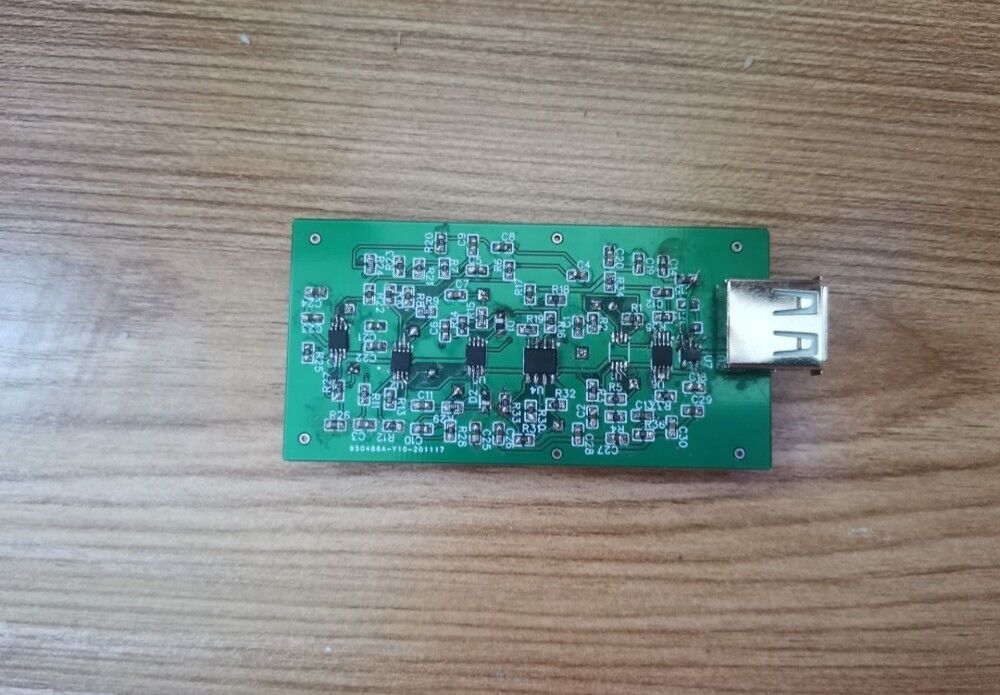

What our team produces is a circuit board that extracts frequency signals so that the signals can be transmitted to the microcontroller for processing and displayed on the LCD screen.
The circuit schematic diagram is designed using Lichuang EDA. The overall diagram is as follows:
Using linear regulators and chips such as LMV358, a series of signal frequencies are filtered and transmitted step by step, analyzed and transmitted.
A linear voltage regulator lamp is used to convert and transmit the voltage signal.
Transmit the converted signal to the LMV358 chip for 16Hz low-pass filtering to extract the DC signal
Receive the low-pass filtered signal and extract the power frequency signal.
Amplitude detection of low frequency power frequency signals
Then, in the same way, the high-frequency signal is extracted, and after a series of processing, the amplitude of the high-frequency power frequency signal is detected, thereby obtaining the frequency amplitude of the light source, etc.
Use Lichuang EDA for PCB design. The PCB design is as follows.
