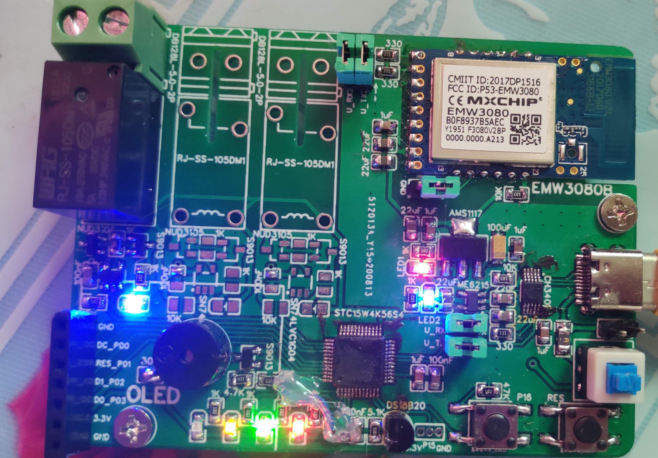

Five: Project results
  1. 3D model of PCB
  1. Physical PCB
  1. APP interface
  1. Implemented functions
    1. When the device is powered on, the buzzer will sound twice to prompt. After connecting to the network, the blue light turns on.
    2. The device reports current device information to the cloud every 5 minutes: the status of the relay and the current remaining working time.
    3. The relay can be controlled on and off through the APP.
    4. Press the button on the device to reverse the relay status and report the device information once
    5. Click and hold the button, and the buzzer will sound the corresponding button sound.
    6. Set the remaining working time on the APP. After the device receives it, it will start counting down on the device. When the time is up, the relay will reverse. The countdown can be set up to 24 hours. When the time is set to 0 or greater than 24 hours, no countdown is performed, and the countdown is turned off by default.
    7. You can set a cloud timer, similar to an alarm clock. Set the relay to turn on or off at a certain time of the day. After setting up, make sure the APP is running in the background.
Six: Project summary
  1. After the EMW3080 refreshed the firmware, the serial port used AT commands to communicate, and the baud rate was set to 115200. The communication failed and was garbled   . When the firmware was refreshed, the BOOT was grounded through the jumper cap, and I forgot to unplug it after the firmware was refreshed, causing the communication with the serial port assistant to fail. When EMW3080 is working normally, BOOT is not connected to GND.
  2. The Alibaba Cloud platform is set up, and the EMW3080 is controlled directly using AT commands through the serial port assistant. However, the EMW3080 cannot be scanned through the cloud smart APP. The EMW3080   initially used the network distribution method 2. When scanning on the mobile APP, peripheral devices cannot be scanned, and the reason has not been found. Modify to network distribution mode 1,. Scan the distribution network QR code directly through the APP to connect successfully.
  3. There is no problem with the program. After downloading it, the communication between the serial port 1 of the microcontroller STC15W and the serial port assistant has been garbled, and the baud rate is wrong   . When downloading the program, STC-SPI requires the IRC frequency when the program is running to be 22.1184Mhz. As shown below:
  1. The buzzer does not sound.   The driving capability of port P52 is too weak, so a pull-up resistor is added.
  2. The data of DS18B20 has always been wrong. It is a random number (not solved, please help me).    The variable FloatTemperature is not initialized, resulting in a random value. Due to unknown reasons, the judgment if (DS18B20_RAM[8] == DS18B20_RAM[9]) has never been made, and the Read_T1() function directly returns a random value. Initialize the FloatTemperature to 0 and directly turn off the if(DS18B20_RAM[8] == DS18B20_RAM[9]) judgment. The finally returned temperatures are always about 66 and 133, and the problem is not found. If you have any solution ideas, please leave them in the comment area. Thank you very much.
