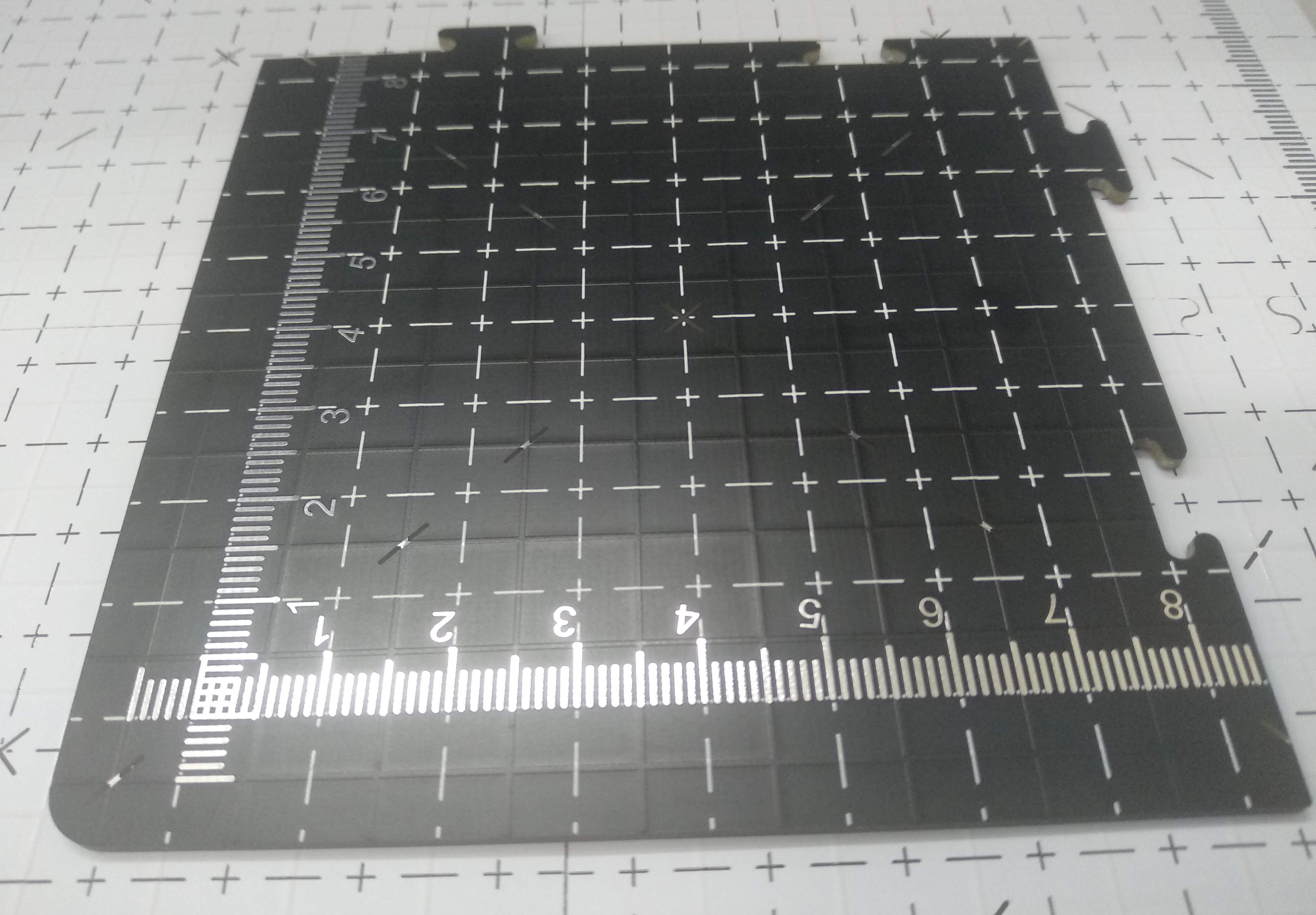

Improvements to the small table cushion (OVO)
  • The top line is bolded and now the scale is clearer
  • Removed the splicing on the bottom left to reduce the number of splicings
  • Add rounded corners and two borders
  • Change the keepout line width to 1mil to improve processing accuracy
  • Add bottom silk screen
  • Remove the bottom pad
  • Files with only corners can be assembled into 4 pieces
  • The side and inner files have been added and can be made larger if needed.
  • When the solder resist color is black, it can be used as a mouse pad, which is slightly uneven.
  • When the solder resist color is white, the surface becomes slippery and is not suitable for use as a mouse pad.
Below is the physical picture of jp and jlc put together
  • The gerber file of the board is in the attachment
  • When you go to jp for printing, you can change the keepout line width to 5mil. It's a bit loose now.
  • JLC’s boards are either loose or tight.
  • The keepout line width needs to be widened and tape needs to be fixed at the bottom otherwise it cannot be picked up.
