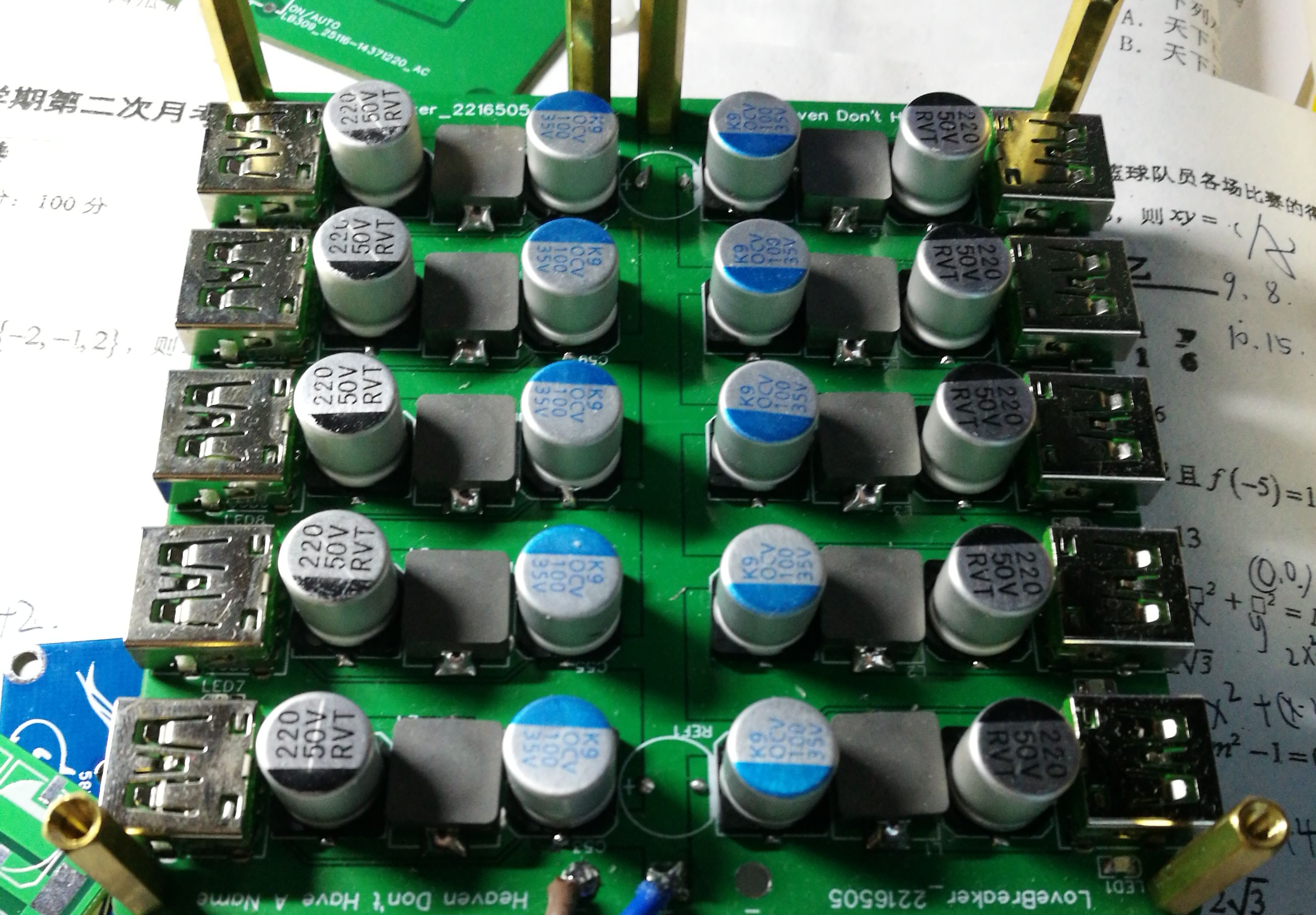

10x10CM size, ten-way IP6505 luxury board
This module is designed for use in scenarios such as classrooms and dormitories with limited sockets and a large number of electrical appliances. It is currently in use in my classroom. It works well and generates low heat. The input capacitance can be appropriately reduced. The input capacitance of a transformer like mine is slightly more. Switching power supplies can reduce input capacitance as appropriate to reduce costs!
IP6505 is the DCDC+ recognition integrated chip with built-in MOS that supports the most protocols at the same price. Each channel supports a maximum output of 25W and a maximum input voltage of 12V. It supports mainstream protocols such as SCP.FCP.APPLE2.4A, MTK, DCP, QC3.0, etc. , the maximum output current is 4A, the input voltage is recommended to be 16-30V, and the maximum input should not exceed 35V. You can increase the heat dissipation conditions appropriately according to your own usage. It can work without power for a long time. It is a mature car charger-level chip. 1585447635479.jpg1585447734821.jpg1585447755784.jpg1585447767356.jpg1585447780586.jpg
