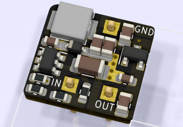

Mini secondary voltage step-down module - compatible with TO-252-2 pin
  • Using DCDC+LDO two-stage voltage reduction, it has the advantages of high efficiency, low heat and low ripple.
  • Output current 500ma
  • Compatible with TO-252-2 pin
  • The actual picture is version V1.2. The latest version, now V1.3, will be tested in the near future.
  • V1.3: DCDC is replaced with ME3116AM6G , LDO is replaced with ME6210A50M3G
  • V1.31: Add feedforward capacitor, increase DCDC output capacitance, and optimize wiring again
V1.3 was tested on the board. The 5.0V efficiency is between 0.6-0.7, and the 3.3V efficiency is between 0.5-0.6.
V1.31 re-board test
Imported from KICAD, unorganized, use with caution. If you need to pattern making, please use the pattern making file I provided.
