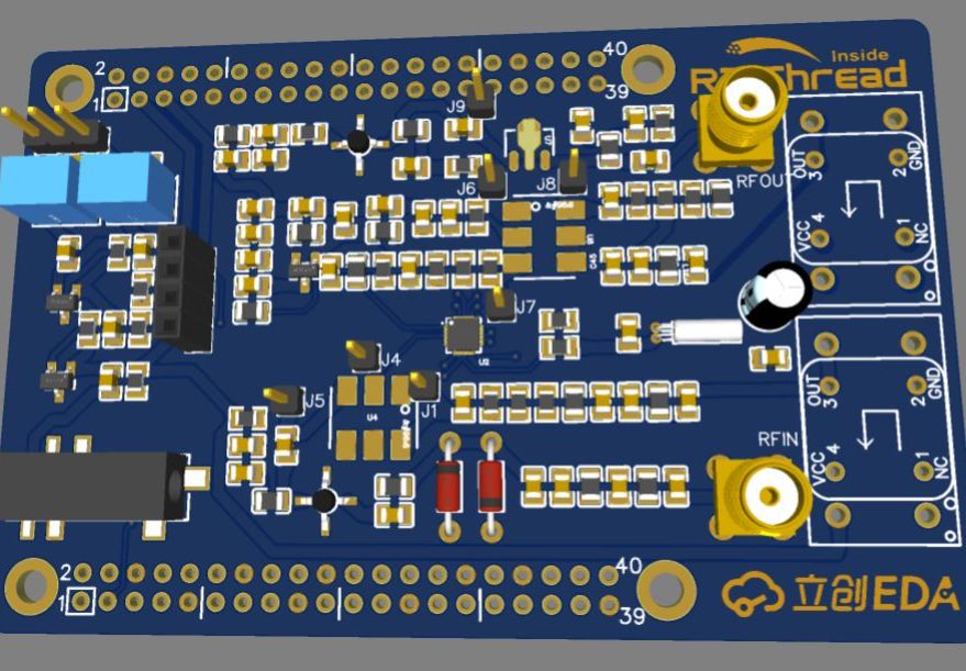

This thing is actually based on the modified chip I made before qn8027和qn8035的DSP信号收发板. The difference is that the main control is changed from stc to art_pi, and the FM transceiver is changed to RDA5820.
Use RDA5820 FM radio transceiver chip to realize the reception and transmission of wireless signals. The frequency band for reception and transmission can be broadened by mixing with other local oscillators.

Signal flow:
  • Reception: The signal is amplified by the antenna and mixed with the active local oscillator in ADE-1, then sent to RDA5820 for processing, and the audio signal is sent to the headset or transmitted to ARTPI through I2S;
  • Transmission: The microphone signal from the headphone jack is amplified/LR input to the RDA5820, and the resulting FM signal is mixed with the active local oscillator. After LC frequency selection, it is amplified again by the HMC580 and transmitted to the antenna;
The role of the mixer: it can expand the receiving and transmitting frequency bands, not limited to the 87-108MHz specified by FM

Updated on 2021-3-27:
The basic part has been completed. It can communicate with artpi through i2c and realize the transmitting and receiving functions of FM band normally. The following is the test environment: IMG_20210327_182607.jpg the spectrum analyzer is connected to the transmit output to test the transmit signal, channel one (yellow) of the oscilloscope is connected to the transmit output, channel two (blue) is connected to the modulation signal input, and the signal generator is connected to the modulation signal input. Set the transmission frequency to 89.8MHz, and the peak signal output from the chip is 4.3dBm: IMG_20210327_182626.jpg Increase the output signal frequency to 100MHz, input 15KHz sine audio signal, and transmit normally: IMG_20210327_184339.jpgIMG_20210327_182615.jpg
The reception was not tested because there is no signal source that can modulate the FM band, but the station can be found using the automatic station search function, which is feasible.
### The spread spectrum part is not completed!
Preparing for the postgraduate entrance examination (Fishing for too long) No time for debugging, but it is available based on previous experience with another board. Note that the inductors L13, L14, and L15 are the inductors of the frequency selection circuit. When using chip inductors, the Q value may be too low and the wave cannot be generated, so they need to be replaced. Wirewound inductors with higher Q values.
