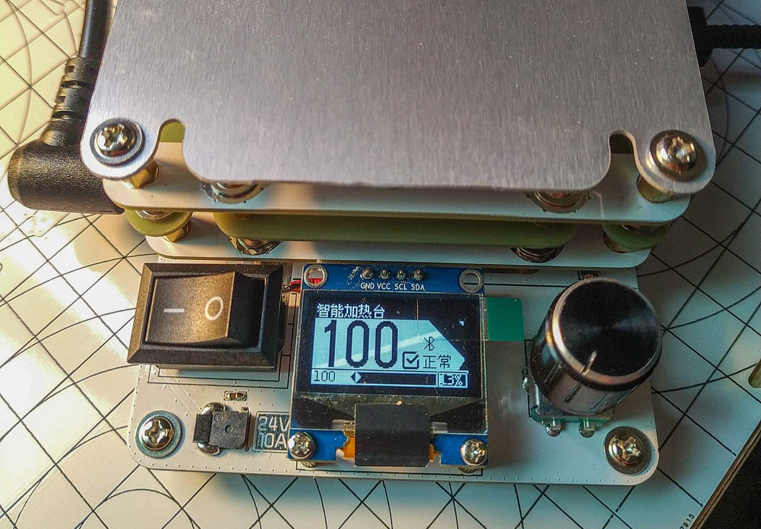

ESP32 heating stage
ESP32 heating stage
Project reference from peng-zhihui/OpenHeat (github.com)
heating plate
The heating plate uses trace resistors on the aluminum substrate to generate heat, and the traces are designed as Hilbert curves.
PCB trace resistance calculation:
Resistivity of copper: ρ=0.0175Ωmm 2 /m
Trace length: L
Trace width: W
PCB copper thickness: D=0.035mm
PCB trace resistance: R=(ρL)/(1000×WD)
Hilbert curve length calculation:
Order: n
Unit length: d
Total length: l =(2 2n -1)×d
The total length of the sixth-order Hilbert curve with a unit length of 1.23mm is 5036.85mm, the trace width is 0.84mm, and the calculated theoretical resistance is about 3Ω. The power supply is 24V/10A, with a maximum power of 192W.
Thermometry
K type thermocouple+MAX6675
Do not use the Teflon insulation layer below for thermocouples. When the temperature approaches 300°C, the insulation layer will melt and cause a short circuit. The insulation layer that can be used is fiberglass.
structure
Screws and copper pillars:
1. M3*5 padded screws×30
2. M2*5 round head screws×4
3. M3*8 double-pass copper pillar×18
4. M3*8+6 single-head copper pillar×4
5. M2*10 double-pass copper pillar×2
6. M3 insulation gasket×2
7. M3 gasket×4
Instructions for use
  • The file system will be formatted when it is started for the first time, which will take some time.
  • Click in the main interface to enter reflow mode
  • Double-click on the main interface to enter power mode
  • Long press on the main interface to open the menu
  • Long press in the main menu to return to the previous level
  • Adjustable PID parameters and Kalman filter parameters
