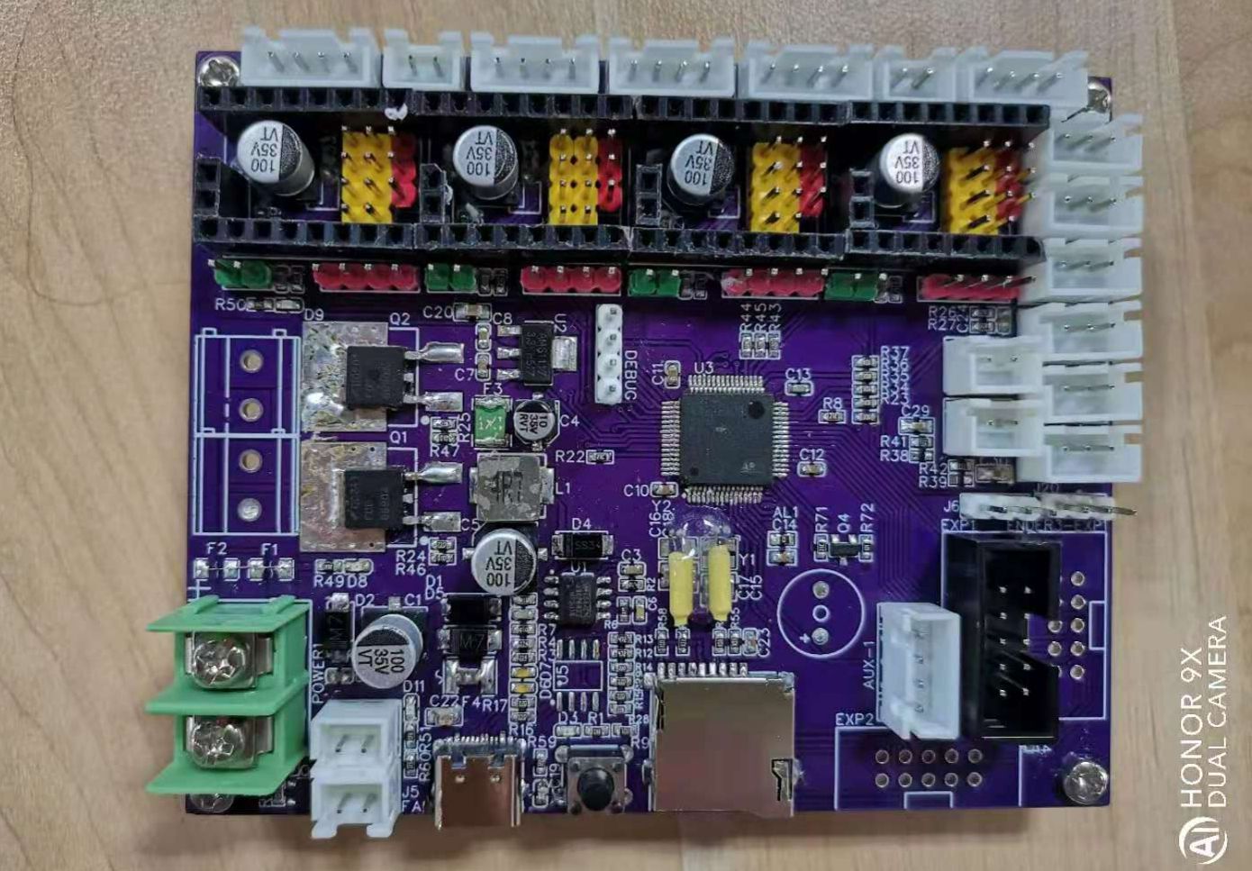

Imitation of MKS Robin E3D control panel, modified some io definitions, size within 10*10
Updated on 2021.8.30

2021.9.9 update
  • Modify the position of the stepper motor drive DIAG (previously, I was negligent and placed the DIAG close to EN, which is incompatible with common modules on the market)

2021.11.11 Update
Update on major error handling: The silk screen printing of the R39 R42 resistor is reversed. Welding according to the silk screen printing will cause the detected temperature to be about 30°C lower than the actual temperature.
PS: Because there is no heated bed, I have never connected the heated bed sensor. I have always ignored the room temperature sampling temperature in the past. I have always followed the recommended temperature of the consumables and the printing effect is very poor. In the test, the printing effect is better when the temperature is lowered to about 20-30 degrees. I suspected the firmware at first. The configuration was wrong, and many modifications in the process were invalid. Since the printing was normal after the temperature dropped by 30 degrees, I did not check it again. Until I remembered it again today, I checked carefully and found that the room temperature should be 20°C. The result always showed around -5, but after changing to the hot bed, the temperature Normal, checked the circuit many times and there is no problem, finally. . . It was found that the silk screen was placed upside down, causing the components to be soldered in the wrong position.

I haven't talked about the firmware before, so I missed one thing. The crystal oscillator in the schematic diagram is 12M, because I only have 12M. In fact, when soldering, try to choose 8M, because the default of platformIO is 8M. The configuration needs to be changed. If you use 12M, you need to search for files and change the configuration, which is more troublesome.
Updated on 2021.11.15
  • tmc2226 (tmc2209) uart test passed
The 2226 module drawn by https://oshwhub.com/481195A/si-ceng-ban-TMC2208-TMC2209bu-ji_copy is used . This module does not add a current regulating potentiometer, so the uart must be turned on. You can also directly replace the 4988 for testing. But the module will be very hot. For the method of directly replacing 4988 and turning on the uart jumper, please refer to https://www.bilibili.com/video/av838173941 . Because of the diag packaging problem, the infinite bit reset is not tested. You must turn on the infinite bit reset. It is necessary to confirm the diag position (the board has been modified once and the diag position has been modified)
