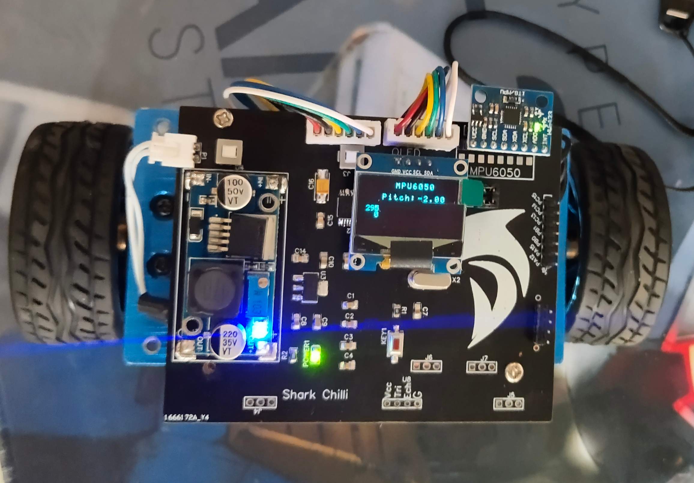

List of materials: STM32F103C8T6 chip, TB6612 motor driver chip, ASM1117 voltage regulator chip 3.3V
0.1uf capacitor 0805 9 pcs
10uf capacitor 0805 2 pcs
20pf capacitor 0805 4 pcs
10uf 16V tantalum capacitor 1 piece
10K resistor 0805 2 pcs
1K resistor 0805 1 piece
200 ohm resistor 0805 1 piece
LED 0805 2 pcs
One each for 8Mhz and 32.768Khz crystal oscillators
2 coding motor female bases
1 OLED display
One MPU6050 module
1 LM2596S step-down module
There are two self-locking switches (hole spacing 3mm), one is used as the power switch and the other is used as the motor switch.
1 power terminal
Several pin rows
HC-05 Bluetooth module 1 (optional)
HCSR04 Ultrasonic 1 piece (optional)
Note: Be sure to adjust the output voltage of the buck module to about 5v before soldering it, otherwise the chip will be burned out.
