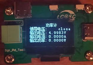

  • A simple and thin "adjustable power supply", the key is cheap.
  • Put various protections (overcurrent, overvoltage) in the PD power supply, and the "adjustable power supply" only induces voltage.
  • There will be detailed welding tutorials to ensure that the entire welding is simple and fun.
  • Modular source code with detailed comments.
     1. Describe project details
  • The main purpose of this product is to make a simple and reliable "adjustable power supply".
  • A simple PD induction chip CH224, which can induce voltages of 5V, 9V, 12V, and 20V. And you can apply for samples from Qinheng original factory.
  • A gain 100V/V current sensing chip INA199A2DCKR, this device can sense the voltage drop across the shunt resistor at a common-mode voltage of -0.3V-26V independent of the supply voltage.
2. Describe the challenges faced by the project and the problems solved
  • There are already many professional or DIY "adjustable power supplies" on the market. Professional "adjustable power supplies" are relatively expensive, and personal DIY "adjustable power supplies" are also time-consuming and difficult to produce.
  • The main purpose of this design is to abandon the 220V part and use a professional PD power supply to provide conversion from 220V to 5V, 9V, 12V, and 20V, thereby reducing the BOM cost and DIY difficulty.
3. Describe the key points involved in the hardware and software parts of the project
The Mcu part uses HK32F030MF4P6 or STM32F030F4P6 and uses an internal crystal oscillator driver.mcu.png
Display part, sampling 0.96-inch OLED, 4-wire SPI mode to ensure display refresh rate oled.png PD induction part, as shown in the schematic diagram, the following voltage can be induced. By default, after power-on, the MCU controls the induced 5V output pd.png system. The total power supply part, 5-40V wide voltage input, fixed Output 5V, 5V to 3.3V is provided by the LDO to provide a clean power supply DCDC.png to the PD induced voltage output. When the induced voltage is equal to the set induced voltage, the MCU controls the transistor and outputs the PD induced PDON.png voltage. The current detection part detects the output current of the PD induced voltage. current.png The PD output part outputs the induced PD voltage. It is welded to a connector by default. Of course, alligator clips can also be welded. out.png

5.1 The power meter host computer based on pyqtgraph is currently being improved. The basic functions have been implemented. Just use TYPEC to connect the power meter to the PC. Please see the attachment for details.
该图是测量锂电池500mA充电时候的电流和电压曲线图
