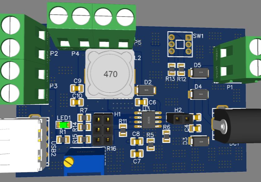

The input voltage of the MP1584 chip is between 4.5V and 24V ; the input voltage needs to be 3V or more greater than the output voltage. It can output a voltage of 5V and a maximum current of 3A. The design goal is to achieve a current of about 2A. When the output is 3.3V, short-circuit the cap to pins 1 and 2; when it is 5V, short-circuit the cap to pins 3 and 4; short-circuit the cap to pins 5 and 6 to achieve 2V~22V adjustment, the current may be very small; not yet Physical testing.
