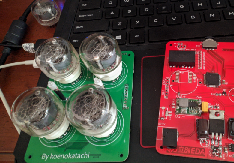

Then the problem came. This hxd directly used someone else's first version of the solution.
First, I don’t like the layout. It’s long and the tubes are asymmetrical up and down.
The second is the old chip used by Bluetooth, which only supports Android 4
Anyway, I feel unhappy, so I plan to half-copy, half-draw, and redo it, and the plan is basically finalized. The drawings on the two boards are similar, but there are things that haven’t been decided yet, and it just so happened that the hub was doing a solicitation this time, so, you know!
Updated on August 1, 2020! The board has been welded, the neon bulb has been tested, and the boost debugging of the control board is almost done, and the triode and 595 ING are waiting to be purchased!
Some sample pictures:
Updated on August 16, 2020! Supplementary picture:
