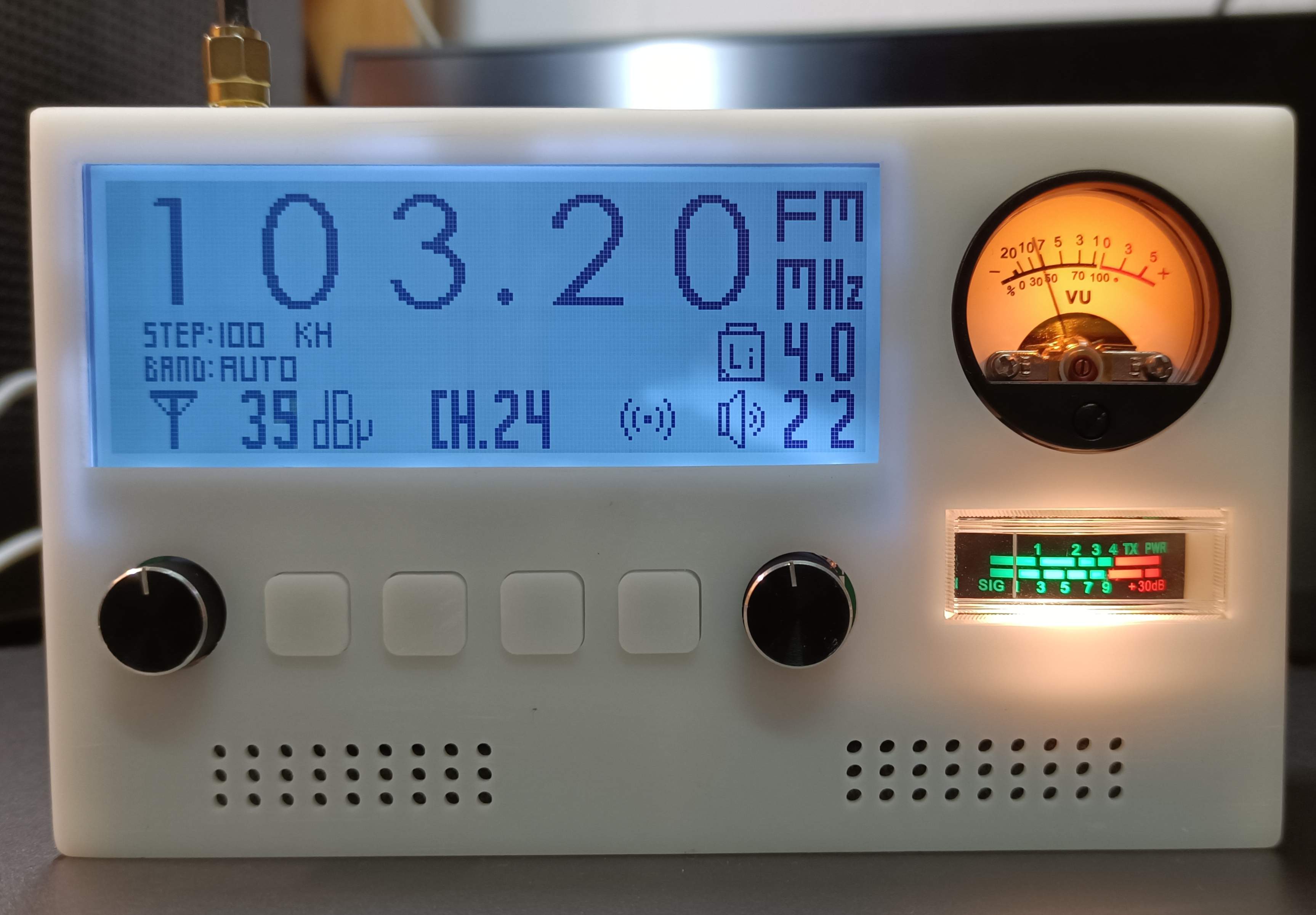

Multi-band radio based on NXP TEF6686

introduction
    • RF reception: NXP TEF6686 DSP single-chip reception, supports antenna feed, with S meter indication
    • Power supply: TYPE-C fast charging input, built-in charging power management, 8000mAH lithium battery
    • Audio: Maxim DirectPath 50mW headphone amplifier, dual Class AB 3W amplifiers, audio VU indicator
More
    • Backlight brightness is adjustable and can be turned off, backlight time is adjustable, and contrast is adjustable
    • The threshold and speed can be set for automatic station search, and stations can be saved manually. Number of stations saved: 100*FM, 100*SW, 50*MW, 20*LW
    • Power-off memory settings and saved stations

The FM band effect is excellent, and the AM reception effect is also good. You can increase the reception effect through an external LNA.
The accessories for the 3D printed shell have been uploaded. The screws are self-tapping with M2*(6,10) and M3*8.
4 buttons need to be printed in the 3D print

2022.5.25
The GD32 version was verified successfully and the UI was optimized. However, during the process of making the GD32 version, I dismantled the STM32 version machine, so the STM32 version can no longer be maintained. In the future, only the GD32 version will be maintained and updated.
The production process is similar to the STM32 version, but the firmware download is changed to USB-to-serial port download. No downloader is needed, only a USB data cable and the official download software are needed.
Let’s put the picture first:
GD32 version
Keil project files, BOM, 3D printing files, download instructions have included project attachments, PCB is still open by clicking the editor in the upper right corner, Board3 and Board4 are the GD32 version , please don’t enter the wrong board
