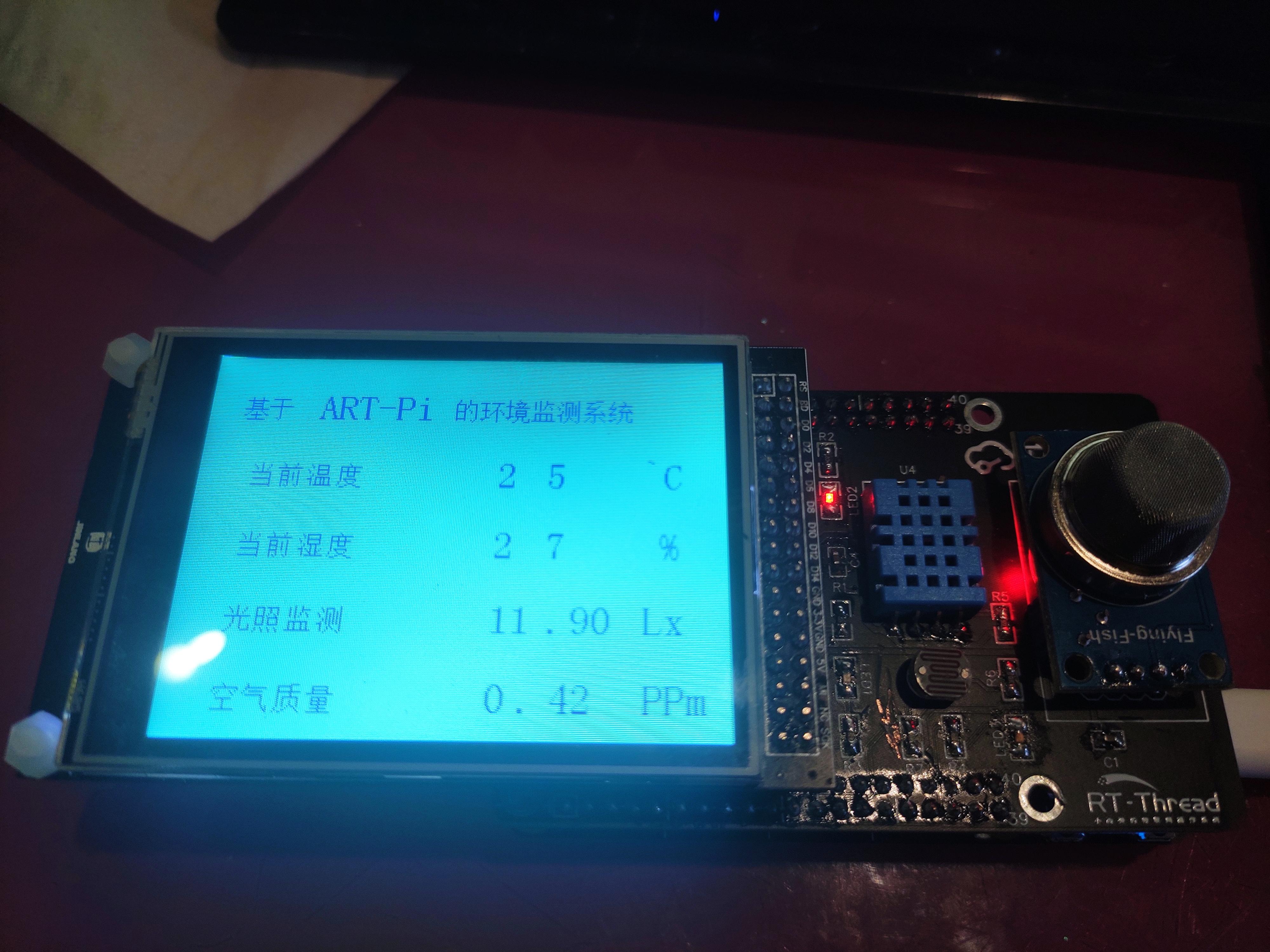

    2. Equipment introduction
          First of all, for the purpose of driving the TFT screen, then add a temperature sensor, MQ2 gas sensor and photoresistor to do an environmental monitoring. This is more suitable for in-car monitoring. The MQ2 gas sensor can monitor a variety of harmful gases. Actual pictures are here       The real thing is as shown in the picture above. The PCB is not too large. It is designed based on the ART-Pi base plate. The pin headers are all Pin to Pin connections because the screen needs to be installed on it, but the photoresistor and MQ2 gas detection module must be external. The only option here is to put half of the screen outside. Let’s see the effect in the picture. It looks good outside. The B boxes are full of O(∩_∩)O as mentioned above, haha~.
    2.1 Main functions
          Currently, non-16 continuous IO ports are used to simulate 8080 timing, and the 2.8-inch TFT screen is driven through the 8080 protocol. This driver transplant is really laborious. The information on the Internet is all 16 consecutive pins, which can be directly operated by bits. Here is the information Open it up for future reference. The functions currently implemented include temperature and humidity monitoring of DHT11, harmful gas detection of MQ2 gas detection module and light monitoring of photoresistor.

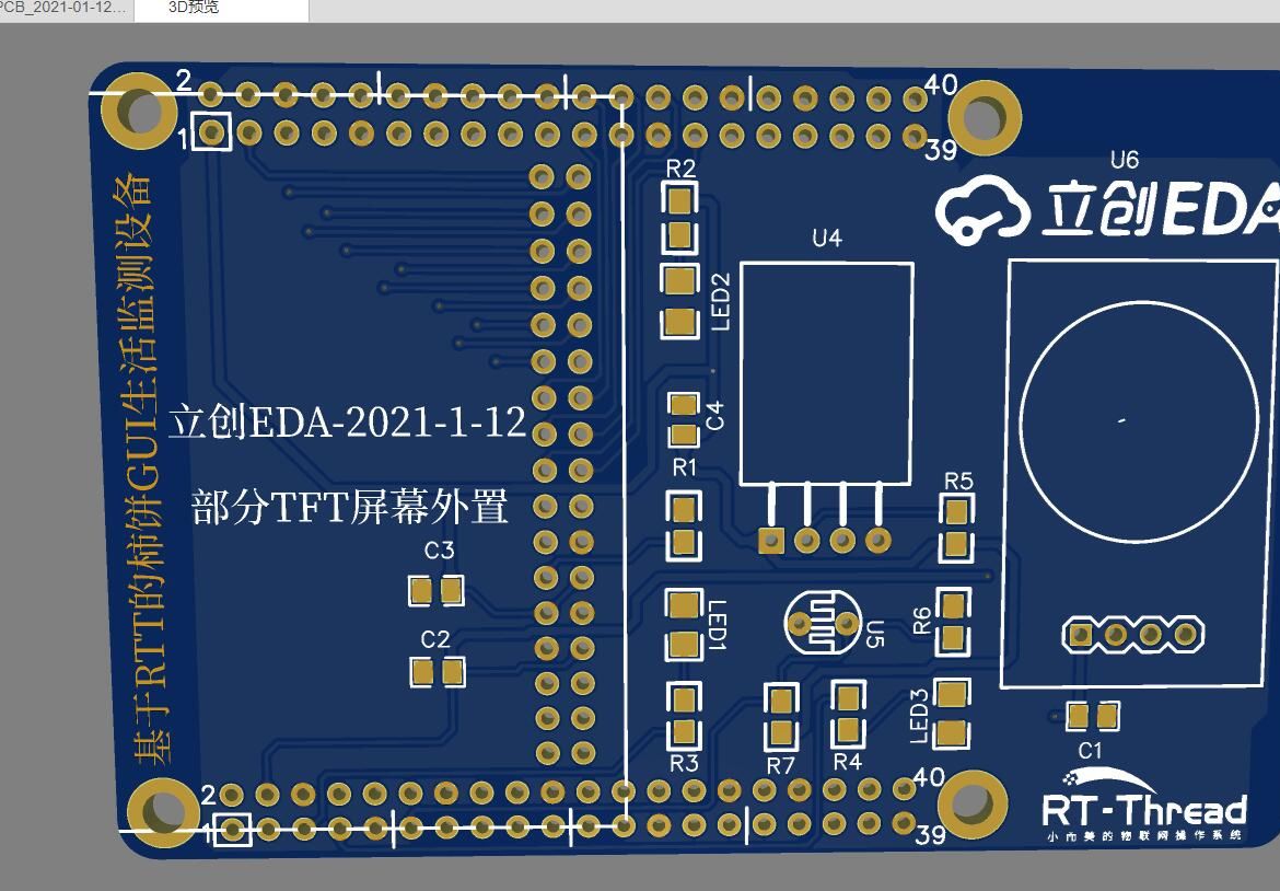

    3. Hardware introduction
          The hardware part is actually quite simple. Of course, the protagonist is our Art-Pi. 16 IO ports are randomly selected as the 8080 protocol pins of the display. At that time, I did not check the ART-Pi manual specifically to connect the 35 37 microphone pins. , so these two pins are currently shared with other peripherals, but I have not enabled other peripherals, so there is no impact. In the future, before drawing the board, you must understand the pins clearly before designing.
Insert image description here       In addition to the 8080 bus, the board also has three LED lights, which are used as alarm lights and normal working status lights. I have to say that this violet color SMD LED is really beautiful. In the past, they were all red and green. This time I came into contact with this If you choose a more slutty color, you will have trouble giving gifts to girls in the future O(∩_∩)O haha~. Insert image description here       The interface of the display screen is simple and crude here. Although these IO ports do not support FMC, in order to facilitate labeling, the network label of FMC is still used. This also makes it easier to write the 8080 protocol for control later. Insert image description here       In order to facilitate pin assignment, I specifically checked the schematic diagram of ART-Pi and marked all the IO ports of the 8080 protocol to facilitate transplantation on RT-Thread. Insert image description here       Here is the junior sensor module,
      1. DHT11 is a temperature and humidity sensor with calibrated digital signal output. Its precision humidity is ±5%RH, temperature is ±2℃, measuring range humidity is 5-95%RH, and temperature is 0~+50℃. DHT11 digital temperature and humidity sensor is a temperature and humidity composite sensor with calibrated digital signal output. It applies dedicated digital module acquisition technology and temperature and humidity sensing technology to ensure that the product has extremely high reliability and excellent long-term stability. The sensor includes a resistive humidity sensing element and an NTC temperature measuring element, and is connected to a high-performance 8-bit microcontroller. Therefore, this product has the advantages of excellent quality, ultra-fast response, strong anti-interference ability, and extremely cost-effective. Each DHT11 sensor is calibrated in an extremely accurate humidity calibration chamber. The calibration coefficients are stored in the OTP memory in the form of a program, and these calibration coefficients are called inside the sensor during the processing of the detection signal. The single-wire serial interface makes system integration easy and fast. The ultra-small size and extremely low power consumption make it the best choice for this type of application in harsh applications. The product is a 4-pin single-row pin package and is easy to connect.
      2. The gas-sensitive material used by the MQ-2 gas sensor is tin dioxide (SnO2) with low conductivity in clean air. When there is combustible gas in the environment where the sensor is located, the conductivity of the sensor increases as the concentration of combustible gas in the air increases. A simple circuit can be used to convert changes in conductivity into an output signal corresponding to that gas concentration. The MQ-2 gas sensor can be used for gas leak detection in homes and factories. It is suitable for the detection of liquefied gas, butane, propane, methane, alcohol, hydrogen, smoke, etc. It is also ideal for the detection of natural gas and other flammable vapors. This sensor can detect a variety of flammable gases and is a low-cost sensor suitable for a variety of applications.
      3. Photoresistor is a special resistor made of semiconductor materials such as cadmium sulfide or cadmium selenide. Its working principle is based on the internal photoelectric effect. The stronger the light, the lower the resistance. As the light intensity increases, the resistance decreases rapidly, and the bright resistance can be as small as less than 1KΩ. The photoresistor is very sensitive to light. When there is no light, it is in a high resistance state, and the dark resistance can generally reach 1.5MΩ. The special properties of photoresistor will be widely used with the development of science and technology.
Insert image description here        These three sensors are used here as the main monitoring devices.

7. The entire 8080 driver LCD.C file is completed, and nearly 1100 lines of code have been written.
8. Use two ADC modules to read the photoresistor and MQ2 module.

6. Physical product
The link to the Bilibili demonstration video will be attached at the end. video hereInsert image description hereInsert image description hereInsert image description here
