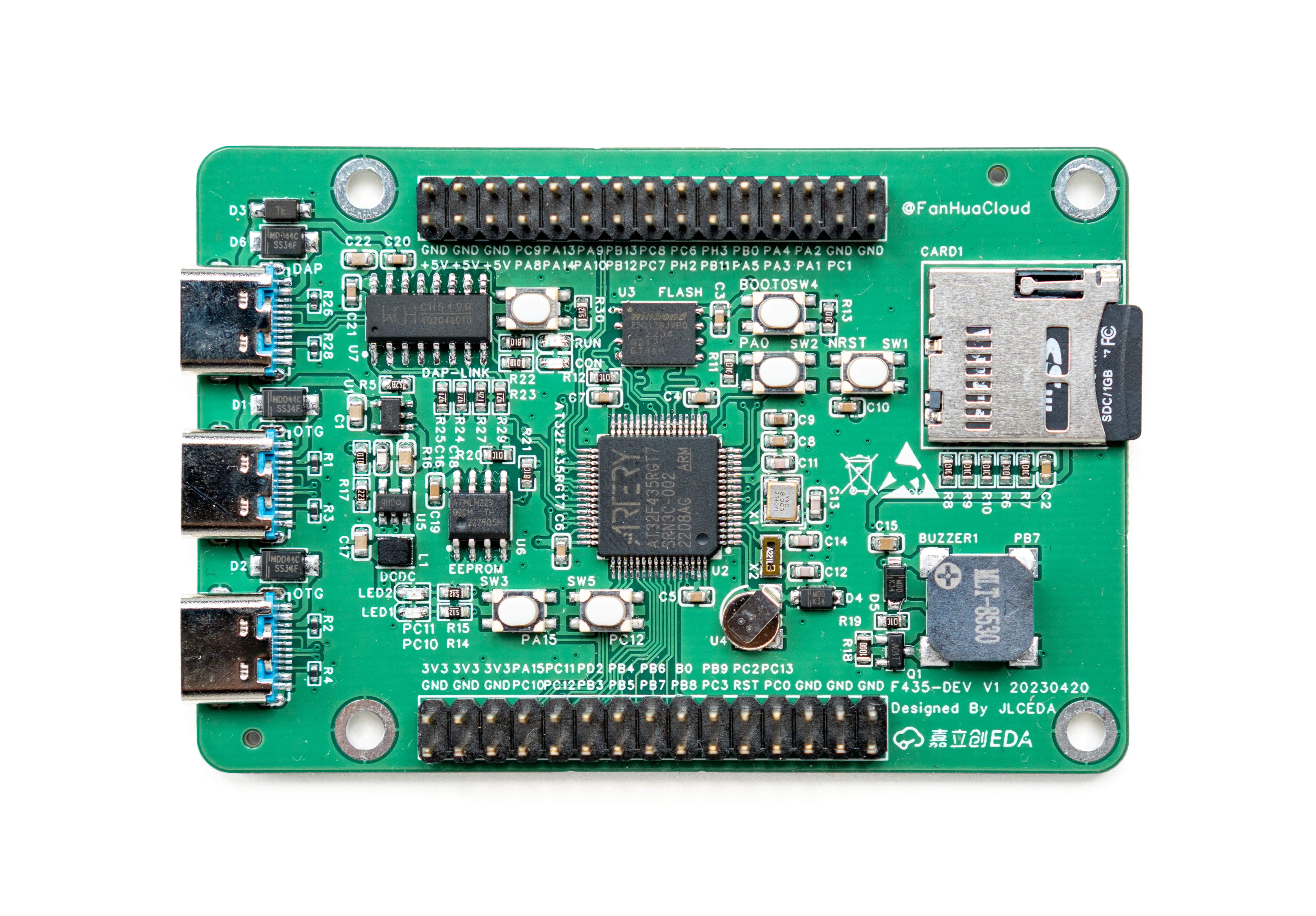

Do you still remember the previous AT32F403AVGT7 development board? After a period of study, this time we bring you the development board of the AT32 high-performance series AT32F435.
AT32F403A development board connection: https://oshwhub.com/fanhuacloud/at32f403avgt7
Chip description
Based on ARM® 32-bit CortexTM-M4F microcontroller + FPU, with 256K bytes to 4032K bytes of internal flash memory, sLib, dual QSPI, SDRAM, dual OTGFS, Ethernet, camera, 18 timers, 3 ADCs, 23 communication interfaces
1. Almost all GPIOs are brought out
2. With SD card interface
3. Onboard DAP-LINK debugger
4. Dual OTG (considering the space, no USB Host port is made, you can make a board adapter yourself)
Development board peripherals
1. AT24C02 EEPROM
2. W25Q128JVPIQ 128Mbit Nor flash
3. Onboard DAP-LINK debugger (based on CH549G)
4. SD card interface
5. Buzzer
6. Two LED lights
7. Button (can be used as normal IO when not in use)
WCH-Link program burns
a new chip. It will automatically enter the burning mode when powered on for the first time. Download the software according to the attached WCH-LinkSCH.pdf, and then burn the program.
If there is a problem with burning, you can press and hold the button next to CH549 to manually enter the burning mode and burn the program.
