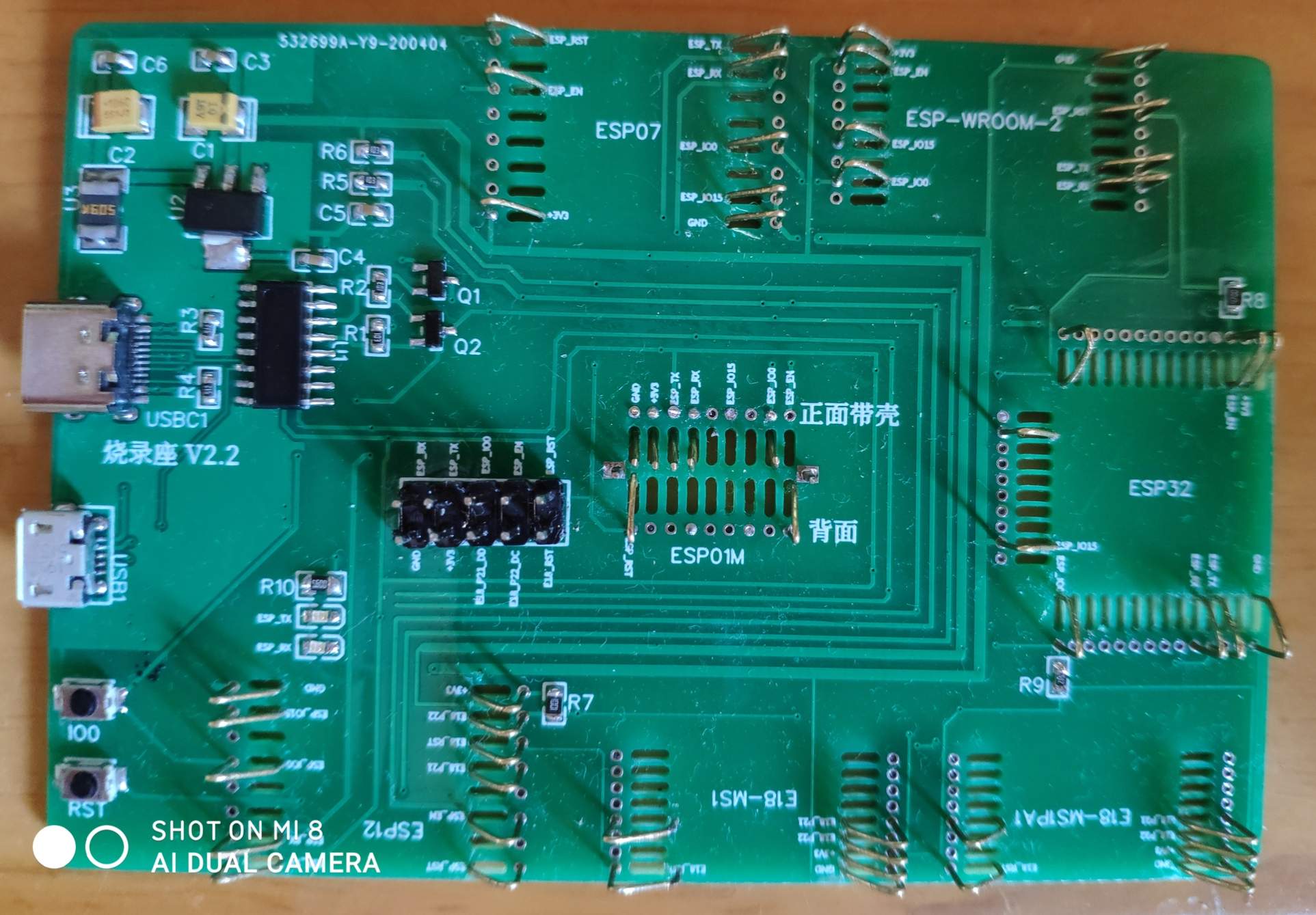

Can be programmed:
ESP-01M; ESP-WROOM-02; ESP-07; ESP-12; ESP32; CC2530 (E18-MS1PA1-IPX; E18-MS1PA1-PCB; E18-MS1-IPX; E18-MS1-PCB) Wait, you need to make
the VCC, GND, IO0, RST, EN, TX, RX pins for ESP programming and the
VCC, GND, DC, DD, RST pins for CC2530 programming by yourself. The price of buying 0.5 diameter phosphor copper wire is about It's 0.8 yuan per meter + 10 yuan postage. Find it yourself.
The pins of ESP-01M are more difficult to get, so you have to figure it out yourself; you don’t need to do the esp-07 position, just use esp-12.
