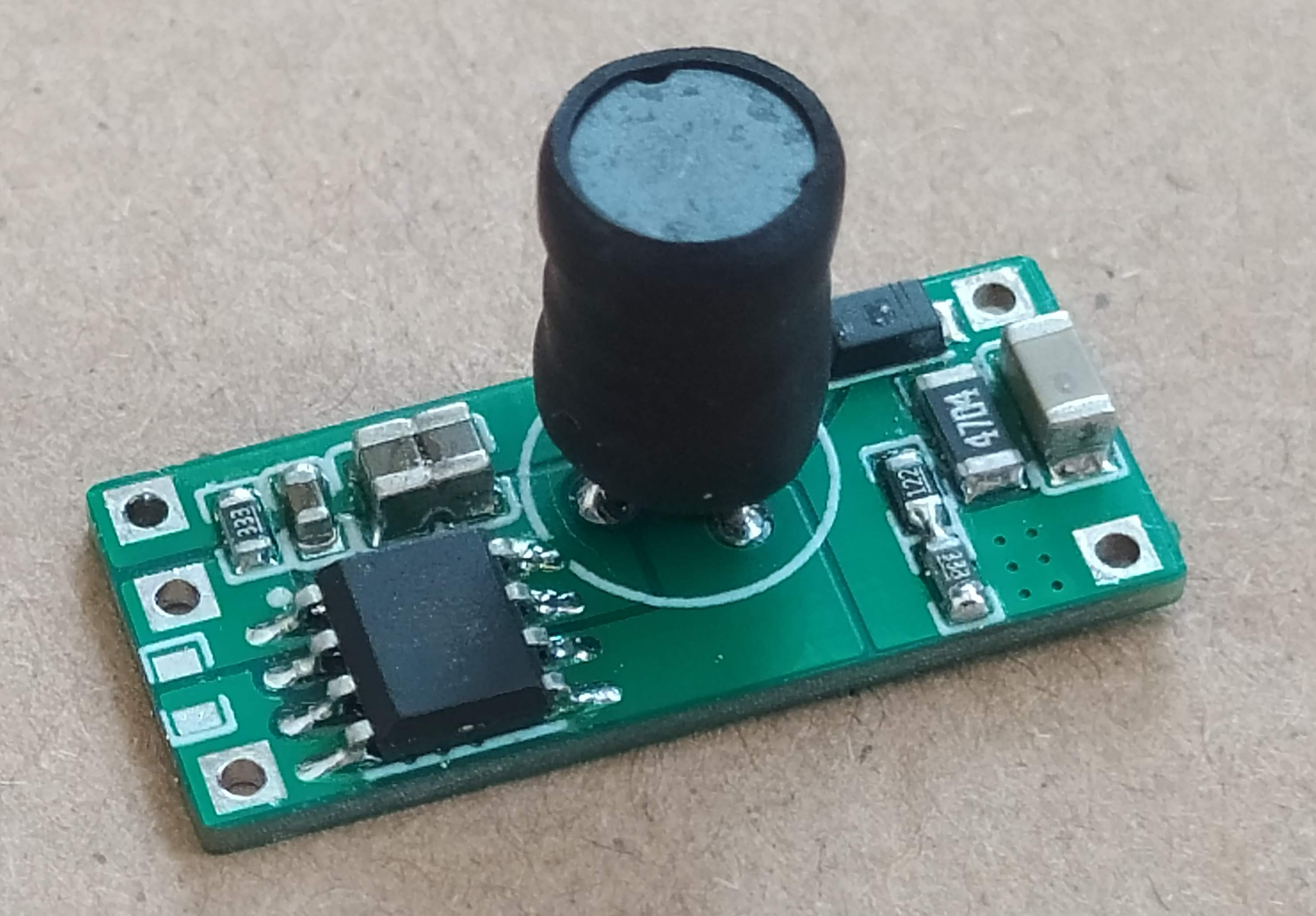

It can be used from 3.3 to 12V, and the output current is not large. The 170V output can be stable at 8 or 9mA at most, and can output a larger current (25mA) in a short time.
Two PCB versions, one with adjustable output voltage and one with fixed output 170V (approximately 172V)
One leg of the three-pin inductor is long and is connected to the SW pin of the power chip.

Low efficiency, low efficiency, low efficiency, the cost of a single module is cheaper than the transformer solution, and the other advantages are gone. . .
