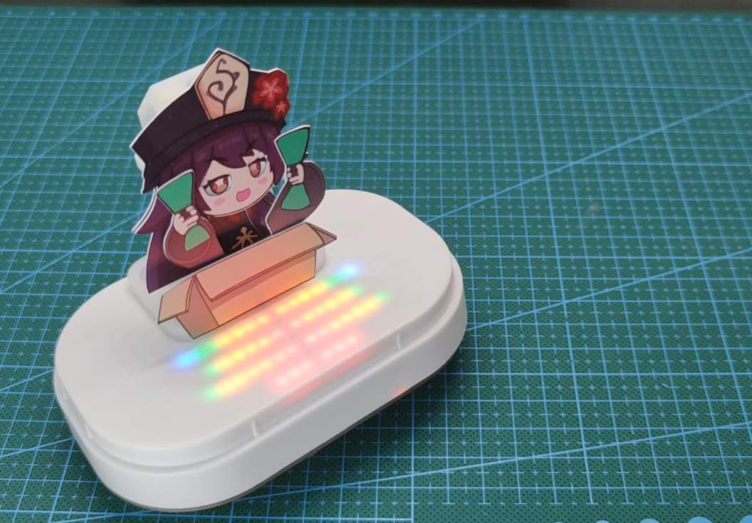

Magic engraved version of walnut shake
The mechanical structure comes from: Station B@witty Kason. 3D drawings improve upon it.
Circuit functions include: lithium battery protection circuit, charging circuit, power display circuit, PWM speed regulation function, Class D power amplifier, Bluetooth audio module, voice playback circuit, wave sensor radar module, 4-channel ten-digit bandpass filter spectrum light control circuit.

In terms of 3D drawings, the bearings were replaced with 2mm diameter stainless steel optical shafts, and the corresponding hole positions in the 3D drawings were also adjusted. The drive motor was replaced with an M10 planetary reduction motor.
