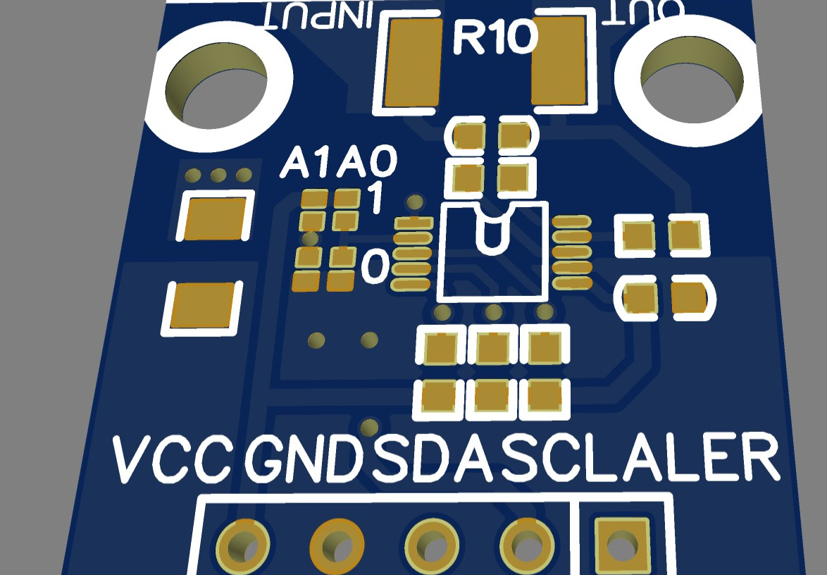

This solution uses high-side measurement, the sampling resistor is 10 milliohms, and the collected signal is communicated with the outside through I2C.
