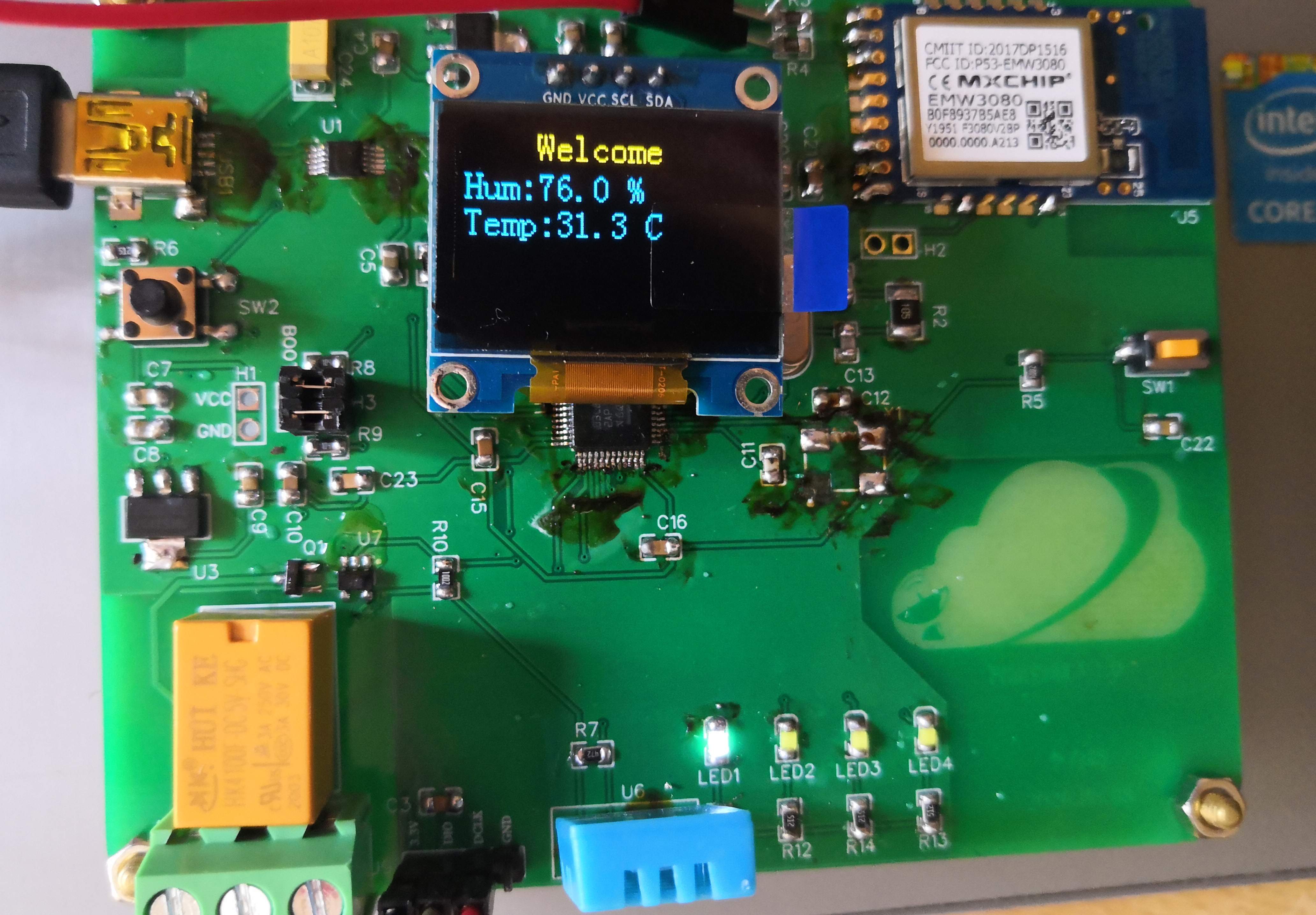

Using STM32F103C8T6 as the main control, the price is relatively cheap, and there is a lot of relevant information online. I have used Punctual Atom's battleship development board before, and I am familiar with STM32f1 series programming.
Send control instructions through the Internet of Things module EM3080 to control the relay switch, and at the same time obtain the temperature and humidity sensor values ​​and display them on the app.
The onboard OLED display simultaneously displays temperature and humidity data and relevant prompt information during operation.
Temperature and humidity sensor model: DHT11, one module can obtain temperature and humidity data, reducing component usage and CPU resource usage
Other parts are basically the same as Lichuang’s source solution.

**1.** Welding part
First weld the minimum system of the microcontroller and the power supply part of the board to test whether the program can be downloaded normally.
Encounter problems :
(1) After welding this part, a short circuit was found between 3.3V_MCU and GND. The pins related to the power supply and ground of the microcontroller were checked and there was no short circuit. Finally, it was found that the problem was with the crystal oscillator used. The crystal oscillator is a 5*7mm SMD package 32.768 The Mhz active crystal oscillator is shown in the figure below. Using too much tin during soldering causes the 3.3V pin and the GND pin to be connected to the metal part of the top cover of the crystal oscillator at the same time. After removing the excess tin, measure again and there is no short circuit.
(2) After confirming that there is no short circuit, power on and test. The point source indicator light does not light up. There is no heat when touching the microcontroller, but the 32.768Mhz crystal oscillator is seriously hot. It has been confirmed that the VCC and GND of the crystal oscillator are not short-circuited. After repeated inspections, we found that the solder entered the inside of the crystal oscillator along the edge of the top cover, which may cause an internal short circuit of the crystal oscillator and cause the crystal oscillator to die. tear down. Since the STM32F1 clock source can be the internal RC oscillator circuit or an external crystal oscillator. Therefore, the board uses an 8Mhz crystal oscillator alone, and the 32.768Mhz is not soldered for the time being.
(3) Download the flashing LED test program. Since only one LED was welded at the beginning, and coincidentally, this LED was connected to the PB4 pin. After downloading the program, there was no response. I thought it was a board problem, so I struggled for a long time. I accidentally saw on Baidu that PB3, PB4, PA13, PA14, and PA15 are special IO ports used as debugging interfaces for the JTAG/SWD emulator. Among them, PA13 and PA14 are used as SWIO and SWCLK for SWD debugging respectively; PB3, PB4, PA13, PA14 and PA15 are jointly used for JTAG. These five IO pins are very special. Normally they are used as debugging pins of the SWJ emulator. If they are to be used as ordinary IO ports, special configuration is required. Different I/O usage requirements and configurations are also different, as follows:
GPIO_Remap_SWJ_JTAGDisable : / !< JTAG-DP Disabled and SW-DP Enabled / That is, PB3, PB4, PA15 can be used for normal IO, and PA13&14 can be used for SWD debugging
GPIO_Remap_SWJ_Disable : / !< Full SWJ Disabled (JTAG-DP + SW-DP) / All 5 pins are ordinary pins, but they can no longer be debugged with the JTAG&SWD emulator and can only be debugged with st-link.
GPIO_Remap_SWJ_NoJTRST : / !< Full SWJ Enabled (JTAG-DP + SW-DP) but without JTRST /PB4 can be an ordinary IO port, JTAG&SWD is used normally, but JTAG is not reset
If you use all five pins as ordinary IO ports, then the remapping configuration in step 2 above should be written as GPIO_PinRemapConfig(GPIO_Remap_SWJ_Disable, ENABLE); if you use PB3, PB4, PA15 as ordinary IO, PA13&14 are used for SWD For debugging, the remapping configuration should be written as GPIO_PinRemapConfig(GPIO_Remap_SWJ_JTAGDisable, ENABLE); In the same way, only PB4 can be configured as a normal IO port.
PA13&14 is used in the project for SWD debugging, and the others are used as ordinary I/O, so GPIO_PinRemapConfig(GPIO_Remap_SWJ_JTAGDisable, ENABLE) is used;
After the flashing LED program test is successful, all remaining components must be welded.
