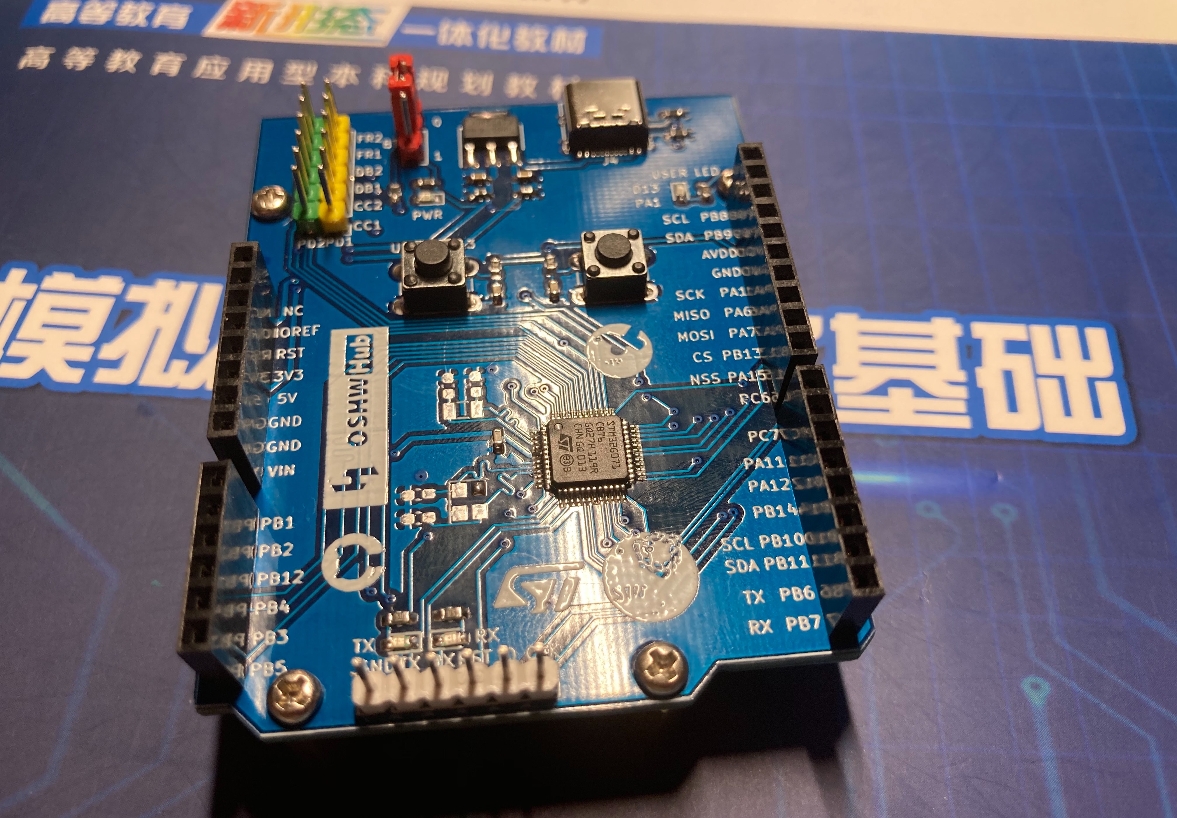

In order to study the development board made by PD, the main control uses STM32G071CBT6, which leads out all the two hardware PD parts, and other pins are led out through the Arduino interface.
This project was drawn using KiCAD and imported into Lichuang EDA. It is recommended to download the gerber file for board making, and for secondary development, it is recommended to use KiCAD to modify the attachments.
Students who use IDEs such as Clion to call openocd should use a newer third-party openocd version. Otherwise, the appropriate cfg file will not be found or the file will not be downloaded even if it is found. (Students using CubeIDE can ignore this)
For instructions on adding this board to CubeMX’s Board Selector, please refer to BV11T4y157uV
Let’s make a complaint, Jialichuang’s silk screen printing is really touching.
