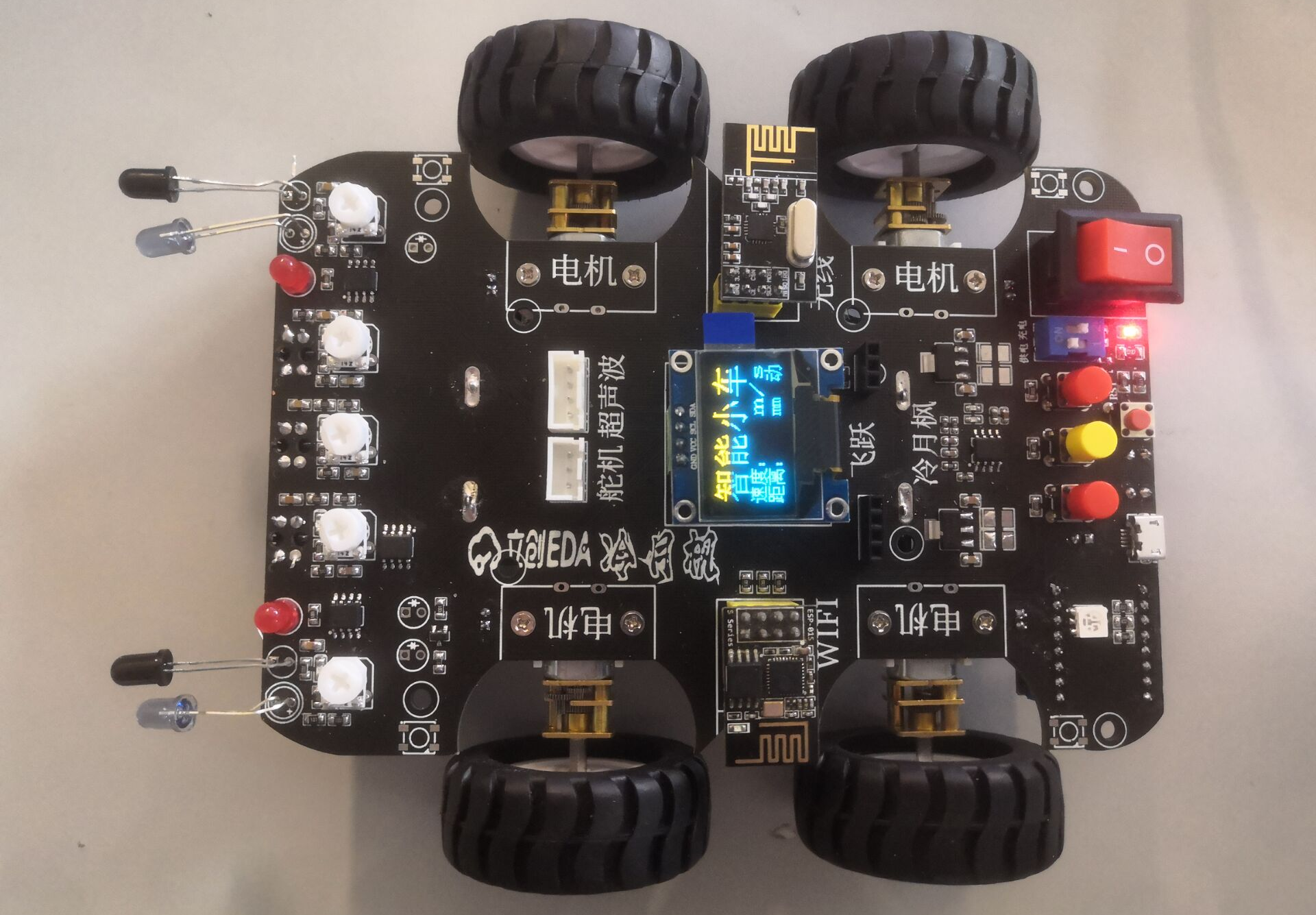

This version is further integrated on the basis of the previous version. A PCB is directly used as the base plate, which looks better. A tracking module is added to make up for the previous shortcomings. The switch is also replaced by a large ship-shaped switch. The operation convenient. Car overall picture.jpgThe fourth version of the car bottom.jpg (It has not been debugged yet. After debugging, the motor wires will be welded directly)

3. Onboard peripherals
  1. Infrared receiving circuit
  2. Infrared obstacle avoidance circuit
  3. Infrared tracking circuit
  4. Motor drive circuit
  5. Bluetooth interface
  6. esp82266 interface
  7. NRF24L01 interface
  8. OLED interface
  9. JQ8900 interface
  10. Ultrasonic interface
  11. Servo interface
  12. Three independent buttons
  13. Left turn signal, right turn signal rear light
  14. Comes with reset button
  15. an RGB light
  16. 4 WS2812
  17. a boat switch
  18. A 2P DIP switch

This step is to expand the function. After the above is completed, the basic car can work normally. If you want the car to be richer, this step is also very important. With my skilled skills, I completed this part of the welding. However, during the test, I found that 3 None of the tracking modules and the 2 obstacle avoidance circuits work (the LED does not light up when in contact)
Since there is a problem, then look for the problem. First, check whether the circuit is soldered properly, and then check whether the resistor is soldered correctly. I found that both are normal (I am confused, it is not a problem with the circuit), because this is my first time. This is the first time I have used this circuit (I used modules in the past). I am not sure. I searched it on Baidu. It doesn’t matter. TMD, there is really something wrong with the circuit. The two obstacle avoidance circuits have no problem, and the three tracking circuits have. Question (I promise I won’t beat you to death for the classmate who copied my homework). I went to see the circuit of Lichuang again (I am autistic, so I should have copied Lichuang’s circuit at that time).
Tracking circuit problem:
Correct circuit:
Error circuit:
I took a quick look and saw that there was no problem. The two pins were connected backwards. What a mess.
I took a quick look and found that the problem is not serious, and there are ways to improve it (will be introduced later)
There's nothing wrong with the infrared obstacle avoidance circuit, so why doesn't it work?
Resistor problem?
At first I thought the adjustable resistor value was wrong. I measured it on the board and it turned out to be wrong (it was only 2K, mine was 10K). I measured the voltage and found that there was also a problem because the product I bought was from Lichuang. , the quality should not be a problem, I think it must be the resistance value affected by the circuit. Because I only bought 5 of them, I had no choice but to remove one from the board and measured it. It was over 9 K, which was normal, which made me even more confused.
Circuit problem?
In order to make sure that there was no problem with the circuit, I took out the original module again. After powering it on and testing that it could be used, I then used a multimeter to test its circuit. I found that it was not much different from my circuit. It was just the resistance of the LED light resistor. The value changes to 1K, which has no effect.
In order to ensure that it was not affected by the circuit, I also used a breadboard to build the circuit of this module, but found that it still could not be used. breadboard.jpgInfrared emission tube problem?
Since there is no problem with the circuit, I wonder if the infrared emitting tube I bought is not the same model as this infrared emitting tube and cannot be used universally? So I removed his infrared emission tube and replaced mine with mine, and found that it still worked.
LM393 problem?
I removed the LM393 from the original module and replaced it with the one I just bought, and it still works, tmd, it’s really strange.
Infrared receiver tube problem?
There are only so many things in the circuit, basically all tested, and the infrared receiving tube, removed and replaced, but it doesn’t work? Could it be that my infrared receiving tube doesn't work? (Looking at the appearance and model, they are all the same.) By chance, I adjusted the positive and negative poles of the infrared receiver tube. It is tmd, and it can be used. It is really tmd, the positive and negative poles are reversed? ( Does it mean that the long pin is not positive and the short pin is not grounded? ) I hope some master can leave a message for me.
Now that the problem has been discovered, the car board also needs to be modified, disassembled, welded, and powered on. I'll do it. (It's really not easy. It took me all night and several hours.) )
