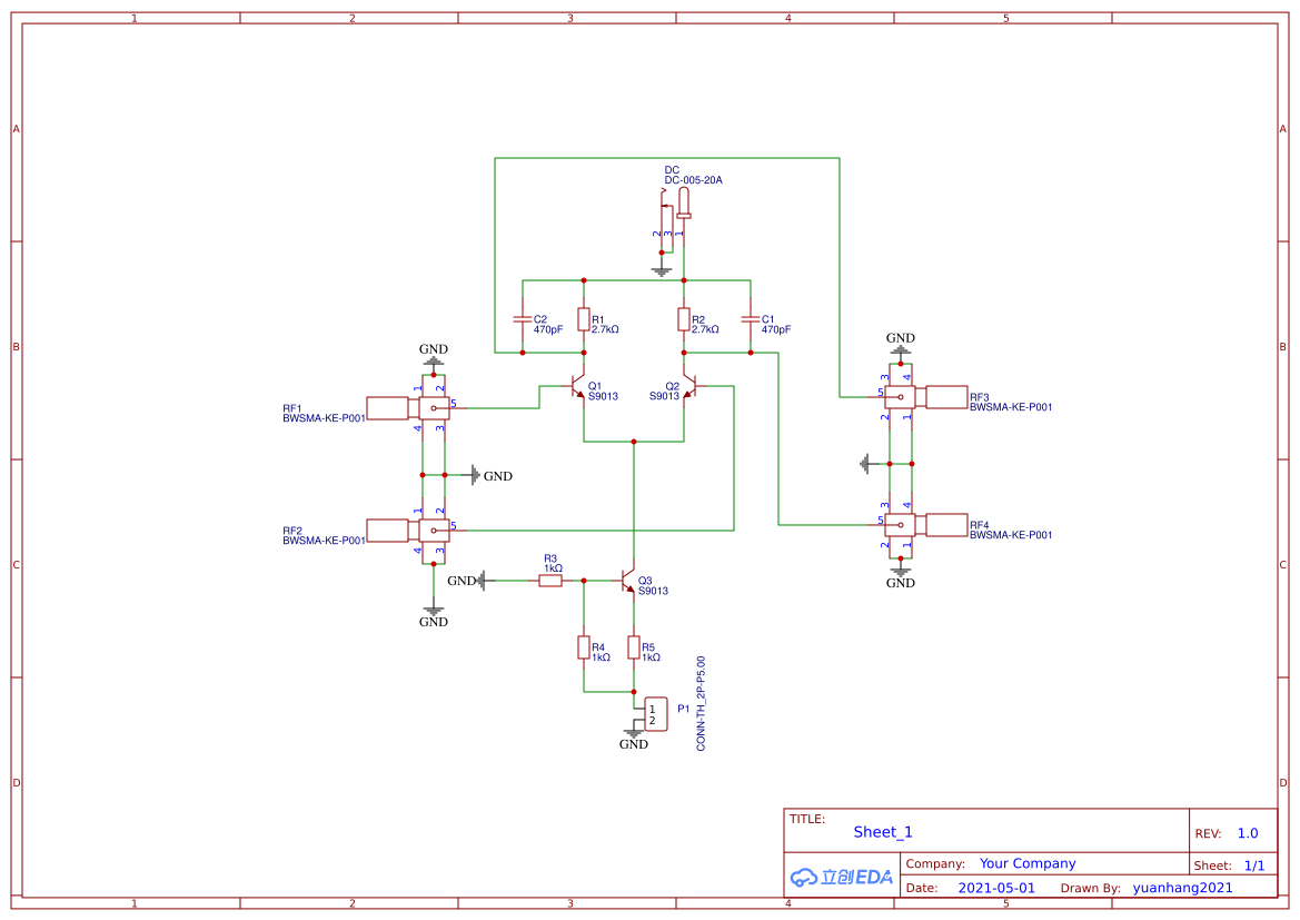

Abstract : This tester uses the STM32F 103 series microcontroller and the Arduino Uno microcontroller as the core control device. It uses the DDS module, amplifier and resistor divider circuit to generate a differential signal U id with adjustable amplitude and frequency . It builds a triode differential amplification according to the problem. circuit and debug it to work normally. By collecting the input voltage U i d and the current I i d flowing through the input resistor , the input resistance R i d is calculated ; by collecting the output voltage U od, the voltage amplification factor Avd is calculated ; and In order to measure the amplitude-frequency characteristics of the differential amplifier circuit, write a program to display it on the display screen.
The voltage amplification factor and input resistance of the amplifier were measured at 1KHz. From measurement and calculation, it was found that the amplification factor was approximately 32 times and the input resistance was approximately 50 ohms. This tester basically meets the requirements of the question.

2. Theoretical analysis and calculation
1. Calculation of theoretical voltage amplification factor
figure 2
The circuit under test is shown in Figure 2 as a differential common-emitter amplifier circuit.
Through the simulation software, set the differential mode signal frequency to 1KHz, input the differential signal into the differential amplifier circuit, and connect the input signal and output signal to the oscilloscope. Observe, record and measure uid and uod, and calculate the theoretical voltage amplification factor by calculating Avd =uod/uid.
2. Calculation of theoretical input resistance
Through the simulation software, set the differential mode signal frequency to 1KHz, connect the differential signal to the oscilloscope, observe, record and measure uid on the premise that the waveform is not significantly distorted, and use a multimeter to measure the input current Iid, and apply the amplifier's input resistance formula Rid =uid/Iid, calculate the theoretical input resistance as.

2. Measurement of actual voltage amplification
image 3
Use Arduino to control the DDS module so that the input differential signal frequency is 1KHz, input the differential signal into the differential amplifier circuit, and connect the input signal and output signal to the oscilloscope. When there is no obvious distortion in the waveform, observe, record and measure uid and uod. By calculating Avd =uod/uid, the actual voltage amplification factor is calculated to be 32 times.
3. Calculation and measurement of actual input resistance
应用Arduino控制DDS模块,设置差模信号频率为1KHz,将差分信号连接至示波器,在波形未明显失真的前提下,观察,记录并测量uid,并使用万用表测量输入电流Iid,应用放大器的输入电阻公式Rid =uid/Iid,计算实际输入电阻为50欧姆。

2测试结果及分析
2.1、放大倍数测试
使差模信号频率稳定在1KHz下测量并计算放大器的电压放大倍数和输入电阻。
2 放大倍数测试表
输出/输入电压
测量值
uod
3.52V
uid
0.11V
Avd
32
根据电压放大倍数公式Avd =uod/uid,计算Avd=32。
2.2、输入电阻测试
3 输入电阻测试表
Uid
0.11V
Iid
2.2mA
根据输入电阻公式Rid =uid/Iid ,计算得实际输入电阻Rid=50欧姆。
