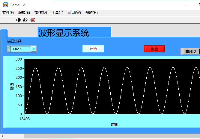

Measurement display (LabVIEW as oscilloscope):
       The measurement display part uses Labview as the waveform of the host computer to display the signal, and uses a simple state machine architecture to display the waveform sent by the host computer. The implementation method is to input the waveform into the differential amplification circuit, and the amplified waveform forms a data packet. The header is hexadecimal FF and the packet tail is hexadecimal EE . The data of the source signal is read through the Arduino microcontroller and sent through the serial port. Give Labview a host computer, unpack and display the data in the host computer part.
       By unpacking the signals sent by the slave computer, two sets of LabVIEW programs were written, which were to display the simple DA -converted analog signals and amplified signals built on Arduino through the breadboard . After the LabVIEW programs were written , package the program as an exe file so that the program can still be used on a computer that does not have LabVIEW installed .
Sine wave:
Oscilloscope shows:
