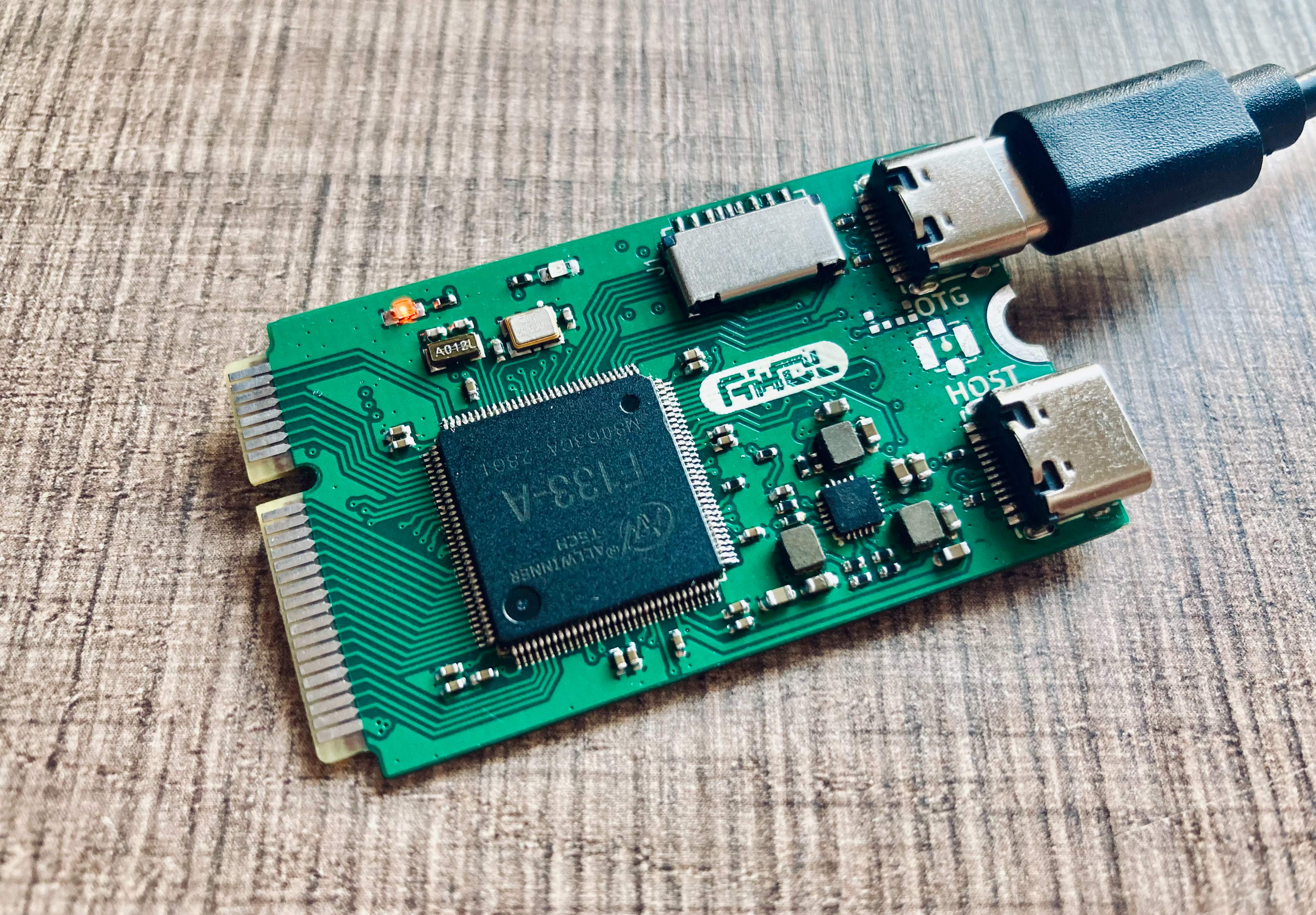

YuzukiNezha D1s RISC-V Linux core
After experiencing the risk of failing the final exam, going home as soon as the board was sent to school, and stopping the delivery of components due to the epidemic, it is finally here: YuzukiNezha D1s
  • Mini PCIE version, lead-out interface, can be freely matched with Ethernet, RGB screen, MIPI screen backplane. No cable connection required.
  • Onboard power tree, USB interface, TP cable interface, SPI and TF card slot. PG11 leads to an LED, which can be lighted happily without a base plate.
  • The four-layer board design and craftsmanship do not require extra money (it is better to spend money), and the 0402 elegant resistance and capacitance.
  • Onboard WiFi module, various adapter modules can be welded.
  • LCEDA format, OSHWHUB and Github open source. ProtocolCERN-OHL-P
Let’s take some pictures
Front view
Rear view
Three Brothers
