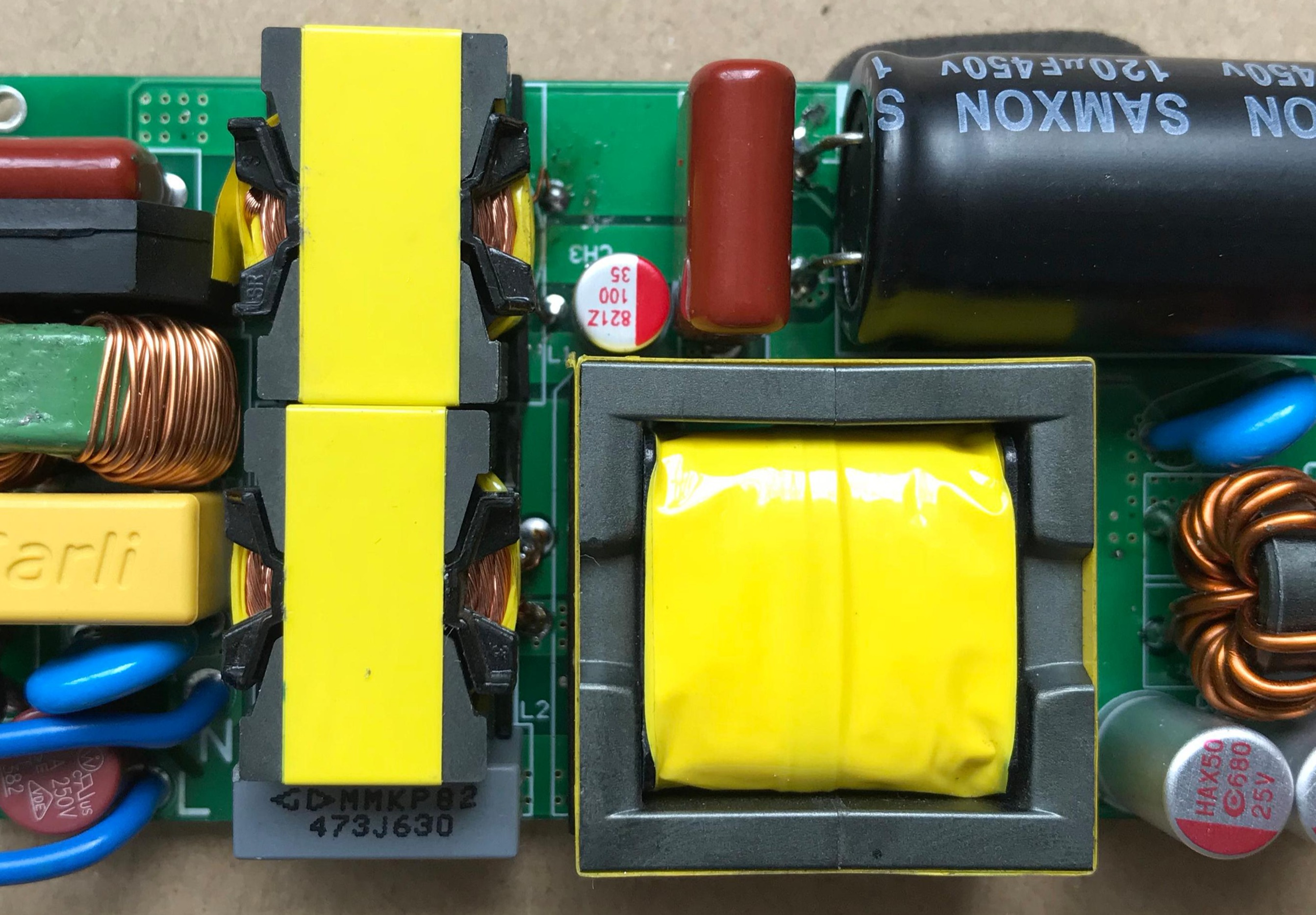

1. The appearance of the whole machine or the PCBA picture after welding and assembly;

   The main features of this design are reflected in small size, high power density and high efficiency; it has achieved 90-264Vac full voltage input, which
is suitable for voltage use in various regions around the world. ** It further reduces the size, reduces heat, and is convenient for carrying or installation; it also makes a little contribution to energy
saving .

I remember that I bought the ticket on June 20th, the last bus for registration. Two months have passed in a blink of an eye. Because I am busy at work, I have been working on this power supply intermittently. I will do it when I have time, so it has been dragged on until now to be basically completed. At first, I saw a master making module power supplies in this area on the power supply website. I also like to tinker with power supplies, so I am ready to tinker with them. This power supply has two versions. The first version is based on UCC28019/L6599/TEA1995. Due to the high PFC standby power consumption, it was abandoned. The second version is the current version, based on NXP's TEA19161/TEA19162/TEA1995. This chip is a relatively popular current-mode LLC. Its standby power consumption can also be relatively low, and all aspects of protection are also complete.
In fact, the adjustment of the resonance parameters was anticipated at the beginning of the design. LLC power supply cannot be made perfect with calculated data. After comprehensive consideration, the series resonant inductor was decisively used for design, rather than the leakage inductance of the main transformer; mainly from the convenience of debugging, dispersing the heat of the main transformer, and reducing the volume of the main transformer. This avoids the tedious process of constantly disassembling the transformer during debugging; it also avoids the problem of transformer interference. At the beginning of debugging, it was not adjusted to the best working state (f=fr). There are also relevant explanations in the post. Friends who want to know can see the detailed explanation below; the day after tomorrow, by adjusting the transformer turns ratio and fine-tuning the input and output voltages, this problem was perfectly solved. The debugging of the power supply has been basically completed. The next step is to optimize the efficiency and equip a suitable shell for glue filling and heat dissipation. In this way, the module power supply is basically completed. The next step is to proof the magnetic components and conduct small-batch trial production. If there are no problems, it will be ready to be put on the market. I would like to thank all netizens for their opinions and suggestions, thank LiChuang for the platform and opportunities provided, and thank LiChuang staff for their hard work. I would like to say to you: You have worked hard! ! There is basically no opinion. The suggestion is that I hope this forum can be better in the future. The forum can be divided into sections and some netizens can be set as moderators (similar to the model of power supply network and 21 power supply network). In this way, the forum will be more dynamic.
