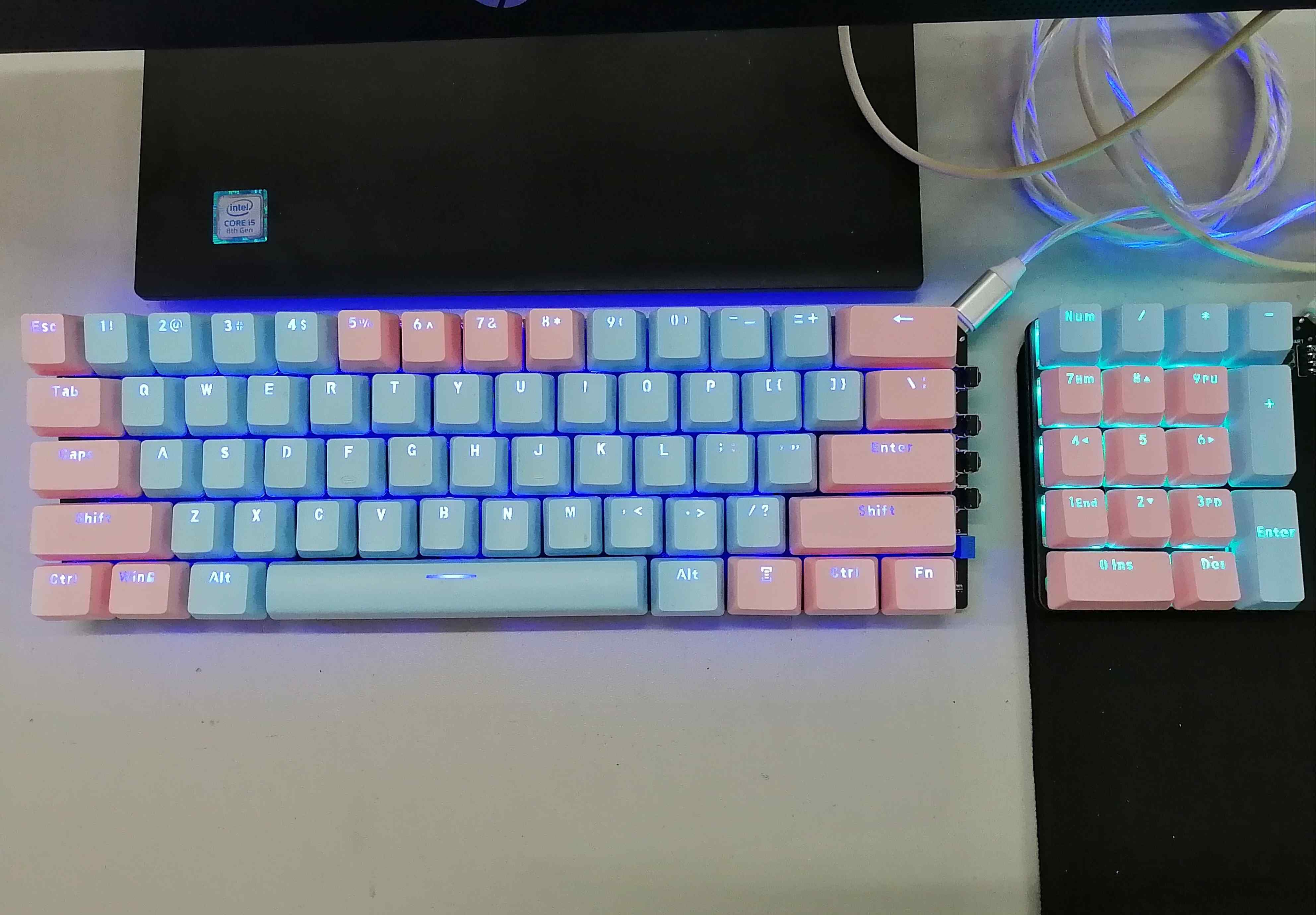

Production process:
PCB front and back:
IMG_20200328_130046.jpg Solder the typeC port first:
IMG_20200328_132522.jpg Input filtering:
IMG_20200328_133410.jpg Power supply voltage stabilizing block:
IMG_20200328_134236.jpg Microcontroller:
IMG_20200328_134645.jpg Exclusion resistor and transistor: (I forgot to order the SMD 8550, plug it directly into the top)
IMG_20200328_185249.jpg Start welding 4148:
IMG_20200328_213207.jpg Weld one side first to fix it:
IMG_20200328_213611.jpg All welded:
IMG_20200328_215628.jpg Close-up: (later I found a 4148 with no tin on one side, just in the picture)
IMG_20200328_215635.jpg Side buttons:
IMG_20200328_220143.jpg Start welding shaft 25%
IMG_20200328_230713.jpg 50%
IMG_20200328_231133.jpg 75%
IMG_20200328_231643.jpg 100%
IMG_20200328_232450.jpg Close-up of solder joints: (4148 without tin is on camera again)
IMG_20200328_232458.jpg Upper balance bar:
IMG_20200328_233345.jpg Add keycaps:
IMG_20200328_234815.jpg Close-up of the sponsor’s logo:

By reducing one channel of PWM output, there are 9981 keys. The light under the caps lock key can also be used as a capital indicator and maintain the same brightness as other LEDs. IMG_20200627_175011.jpg
Add HUB to modify the layout to make way for the USB interface WeChat picture_20210125210145.jpg
