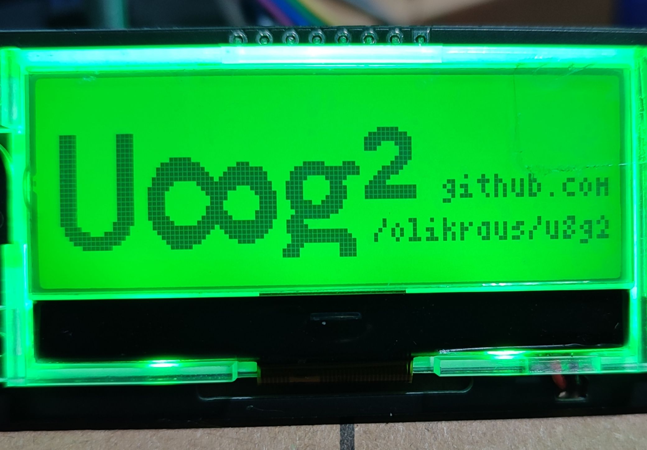

This screen is so green that it makes you panic .
The driver is ST7567
If you use the U8g2 graphics library, U8G2_ST7565_NHD_C12832_F_4W_SW_SPI is the most perfect after testing.
U8G2_R0 is reverse display, U8G2_R2 is forward display
Set the contrast to 70 for the best display effect u8g2.setContrast(70)

display effect:
