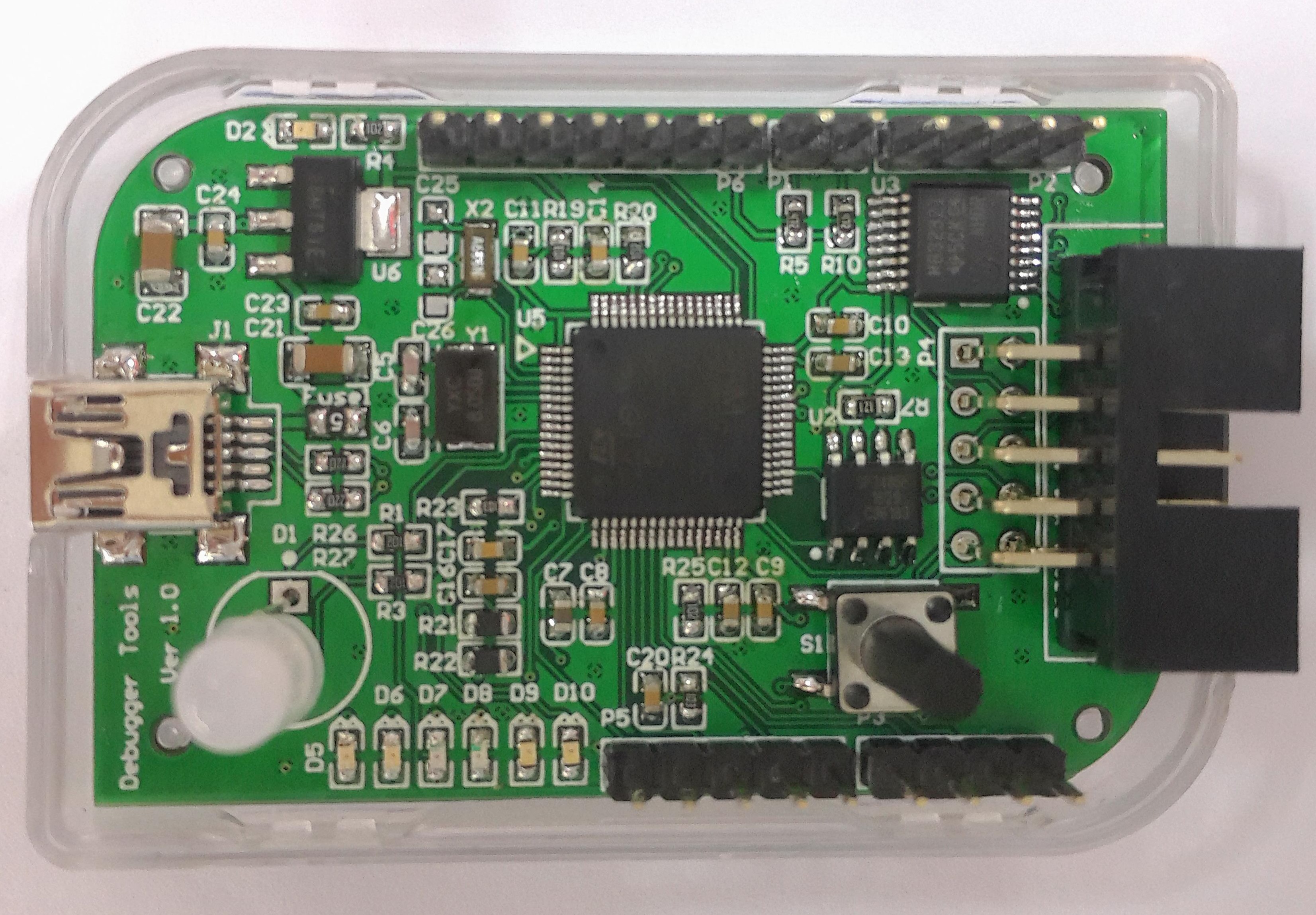

1. Introduction to the work
For example, this may include, but is not limited to, the following:
1. Pictures of the complete machine appearance of the work or pictures of the welded and assembled PCBA;
****  Click for larger image **** **** ****  Click for larger image****  Click for larger image**** ****   Click for larger image****
2. Research background, purpose, function, and market application prospects of the work; A. Research background: As a professional electronic engineer, you often need to communicate with external devices, or debug chip drivers, detect voltages and waveforms, and use voltage value or PWM operated motors and more. B. Purpose: To bring together all the hardware debugging equipment that engineers usually need, saving costs, using space, and being scalable. C. Function: It has CAN, RS232, RS485, SPI/IIC reading and writing, PWM/DAC output, and has script parsing, execution and expansion capabilities. D. Market application prospects: This debugging tool integrates commonly used debugging of CAN, RS232, and RS485 to reduce costs. It also adds functions such as debugging SPI, IIC, etc. You can write your own programs through lua scripting language. This price-performance ratio is definitely the best at present. Unique on the market, the purpose of this tool is to squeeze out the functions and performance of STM32 and give full play to the characteristics of STM32. Through this tool, engineers can complete the basic debugging they want to do better, faster and simpler, and spend more time on Complete more complex tasks. This tool is made of the most common materials on the market, has low maintenance and repair costs, and has a low scalability threshold.
3. What are the highlights of the work in terms of innovation, interest, practicality and even public welfare? A. Practicality: It can debug most communication equipment, write and debug protocols, read and write chips, output arbitrary waveforms, etc., which are communication and signal input and output that electronic engineers often need. Debugging projects no longer require more equipment.
B. Innovation: The basis of innovation must be practicality. Technology is people-oriented and low-cost, but being able to play more powerful functions is the greatest innovation and creates the greatest benefits.
C. Interesting: The invention of this device itself is interesting, and it is also very fun to use. A simple small device can control and collect almost most of the devices, making boring debugging easier, and more The time is spent on functional design, such as the AD sampling port, which can collect ECG module signals. At this time, the device is an electrocardiograph. SPI, IIC and other interfaces are common communication interfaces, which can be connected to most common devices, and can be programmed with Lua to write some drivers to expand IO, sensors, LCDs, etc. They are highly playable, easy to obtain materials, and low cost.

2. Use words to briefly explain the implementation principle of the work and the working process of the system. **** A. Connect the device to the USB port of the PC and install the STM32 VCP version 1.3 driver on the PC. There is a problem with version V1.4. You can then see the serial port of this device in the device manager. **** **** B. Open the host computer software, select the corresponding serial port, click Open, and then select Get. Then you can see the device firmware version number, V1.0, and finally click Connect. If successful, it will turn green. **** C. At this time, the device can configure parameters and send and receive data according to the protocol content. The following is part of the agreement:

For example, some of your experiences in completing the work, technical problems or debugging experience you encountered, future plans for the work, and suggestions and opinions for our organizers, etc. 1. USB driver and buffer issues, it can support 1K byte transceiver . 2. SP3485EN chip is easily damaged, or cannot be used after welding. In the past, SP series chips were often damaged, and the quality was not as good as TI and Maxim. 3. In the future, this work will add and expand more functions and become more powerful. Better support for scripting language, added extended version, can intervene in OLED, MPU, etc. 4. With such works shortlisted, I hope we can further cooperate and benefit more electronic engineers and enthusiasts.
