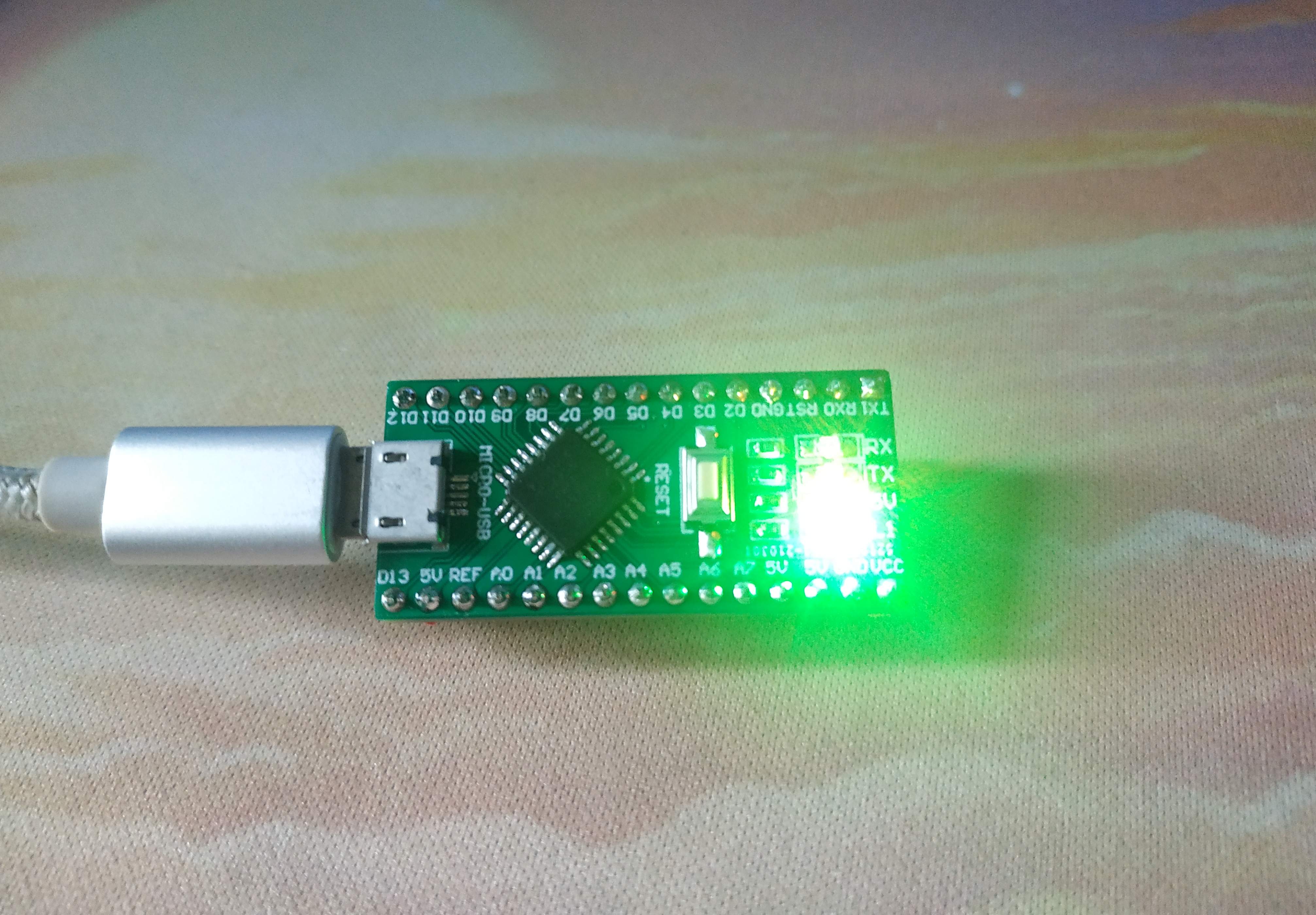

I don’t need to say much about the MEGA328P chip. It is a very versatile Arduino chip. You can also buy the same Arduino Nano development version online for about 10 yuan. However, I don’t really like the development version sold online. There are 6 pins for programming, and the 3V it leads cannot carry a load and occupies one pin, so I made a development version myself. And the online tutorials about burning with uno are a bit confusing, so I will summarize them here.
The front of the picture above is the main body.
The picture above is the back.
The colored pin headers are selected. The main color is yellow, the power supply is red, and the ground is black. The main yellow pin headers look really good with the green board.
The download circuit, crystal oscillator, and power supply are at the back. On the front are LED indicators and chips. The indicators are a power indicator (red), an LED connected to the D13 interface (green), an upload (yellow), and a download (blue). ) indicator light.
If you remember to put the JLCJLCJLC identification silk screen on the back when making it, it will be more beautiful.
This is a side view of the back. You can see that the components do not protrude and it is very comfortable to insert on the breadboard.
However, since it is hand soldering, type-c is not installed, but micro usb is used.
Below is a comparison of several boards. The one above the blue PCB is the most popular Arduino Nano sold online.
In the middle is a piece I tried making before
Below is this piece of the project
You can see that my development board is smaller because it does not have a download interface. The one I made before uses an upright micro usb, so it will cause a problem. If the board is too thick, it will be difficult to solder, so I replaced it. It is SMD type. Of course, this is not the most critical thing. The most critical thing is that the crystal oscillator does not use SMD, which causes the crystal oscillator on the back to bulge and protrude when plugged into a breadboard. It is uncomfortable, so this time I used an SMD crystal oscillator. .
