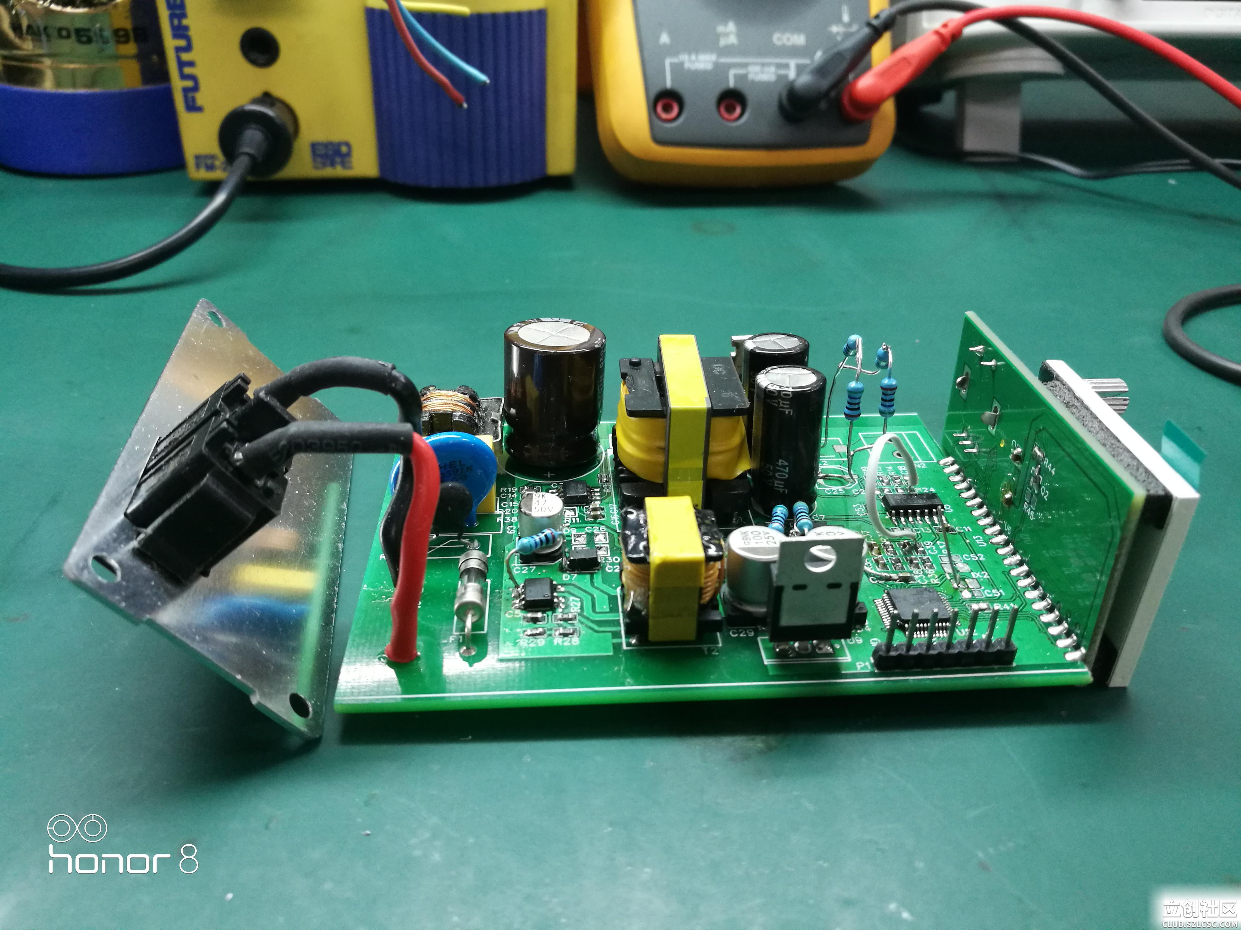

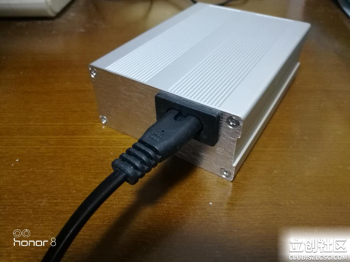

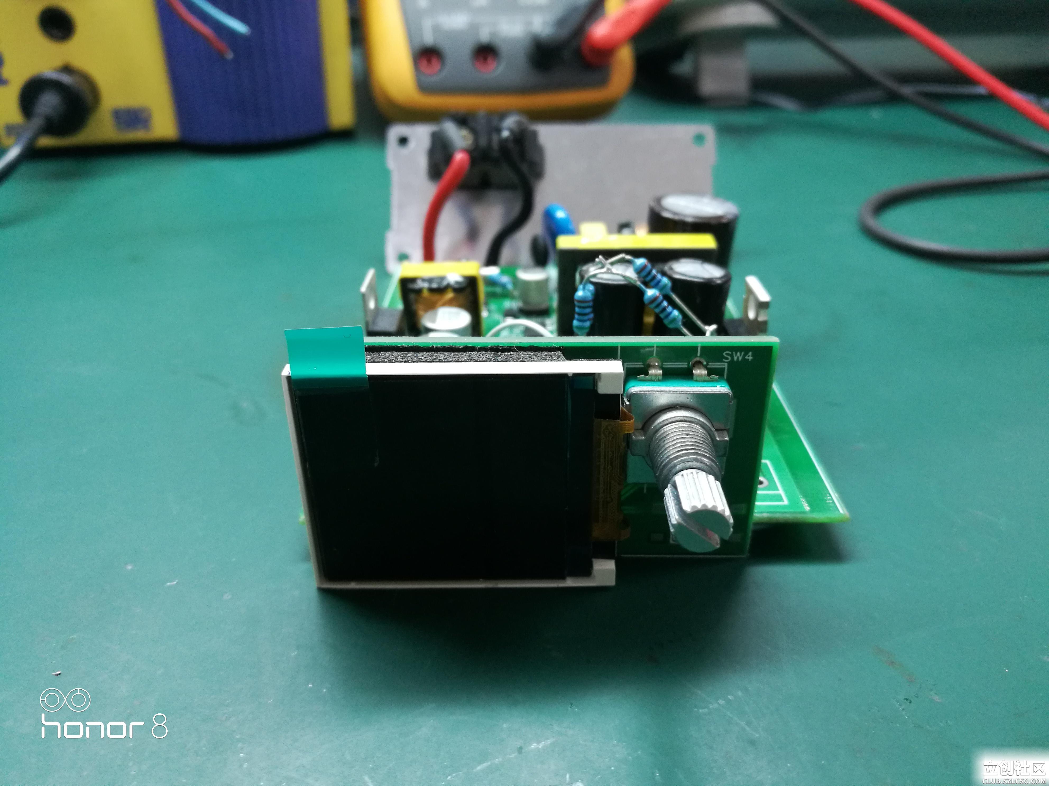

Click to view full imageClick to view full imageClick to view full image2. Actual picture
Click to view full imageClick to view full imageClick to view full imageClick to view full image
Special reminder here: The safety distance between the primary and secondary sides is not enough in the current state! Do not imitate!

      The shell is made of aluminum alloy profiles, and the LCD screen is also a standard size, which is convenient for procurement. It is very convenient for everyone to DIY or imitate in the future.

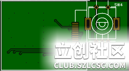

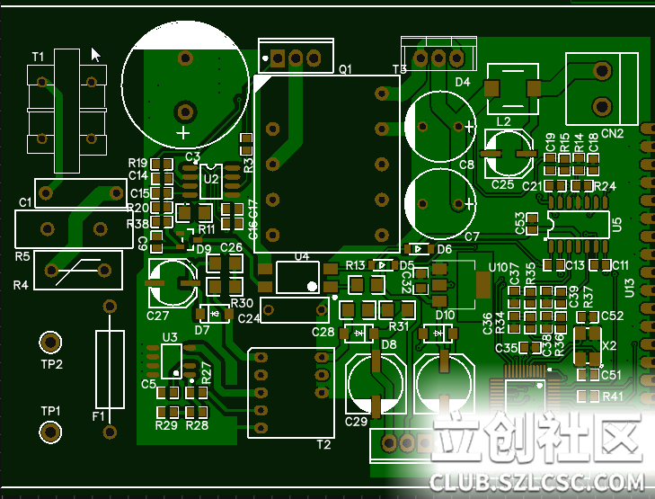

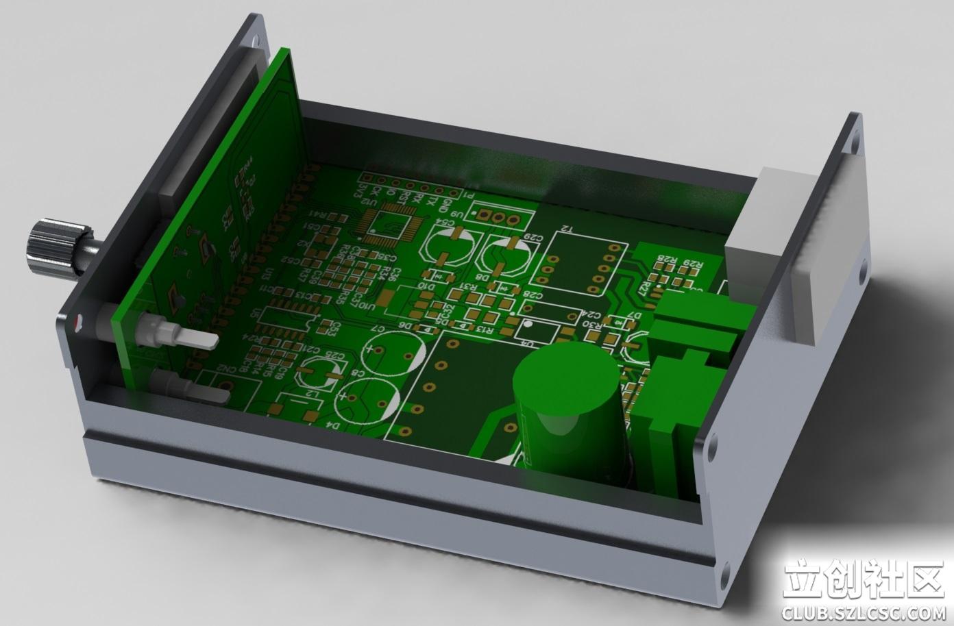

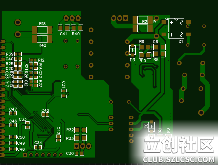

98E32BF7A4404846AD782AC3BC1900B3_146.pngPCB:
A9704C8BAD1F4A20AD6AD16C11017AC5_230.png97D2896EF2264FB9B24A27B501E492F9_506.pngA0964F2EA8C547A8BD94DCCAF974CA42_560.png2F709AADBDED474D94B8B19ED81CA0EC_263.pnghttp://club.szlcsc.com/article/downFile_C05AA4E03ACF07C3.html
A few considerations:
1. This power supply is only a CNC power supply rather than a digital power supply, so the feedback loop is still in analog form. The CNC part completes the voltage and current setting and calibration.
2. Safety, I was entangled in the grounding problem. Considering the heat dissipation, I want to use an aluminum alloy shell. If the power socket is grounded, it will be very large. For the time being, consider internal double insulation first, and then talk about it if it doesn't work.

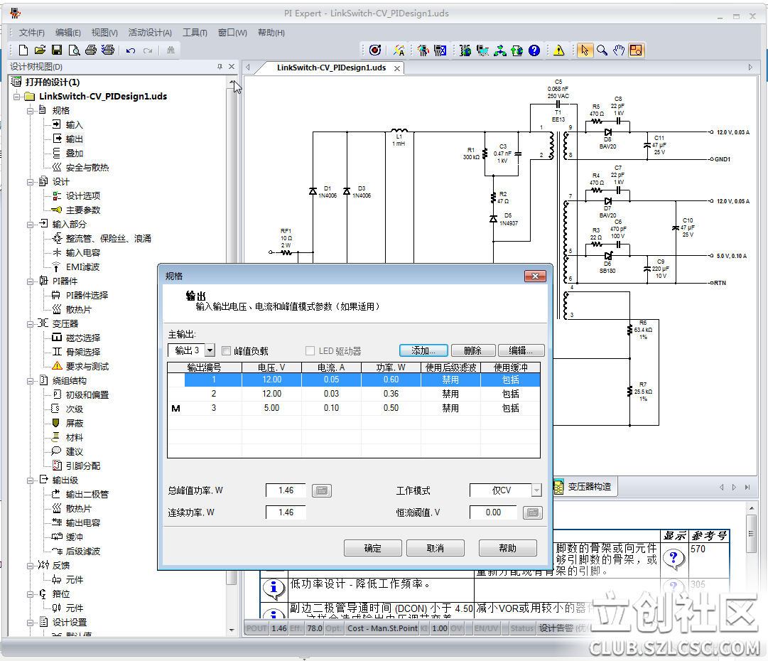

D5004C3B6B0F455FA5C73BFE561E551E_368.pngConsidering that the characteristics of the auxiliary power supply are low power, multiple outputs, and isolation, the flyback topology is specially selected.
The solution uses PowerInt's LNK62x, which has a simple structure and low cost. The solution is mature and is widely used in home appliances.
In addition, the supplier of this solution provides a complete automated design tool PIExpert, which is very convenient for design optimization.

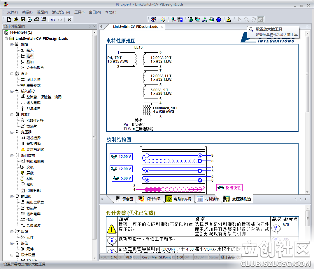

Click to view full imageThe transformer uses EE13 core and 5+5 skeleton according to the structural limitations and the number of output channels. The transformer design output by the software is for reference only. On this basis, I have further optimized the primary and secondary side creepage distance and pin allocation. See the schematic diagram for detailed allocation.
Click to view full imageAttached design engineering file: LinkSwitch-CV_PIDesign1.rar (Downloads: 497)

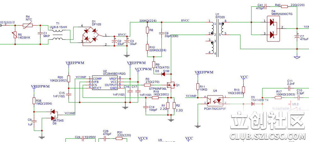

2. Main power stage:
4C28C0B32FE048C1A624639971BEA0F7_161.pngThis part still uses the classic flyback structure. The main controller is also the classic UCx845. I believe that friends who are familiar with power supplies are already familiar with the IC x845, so I will not go into detail about the design.

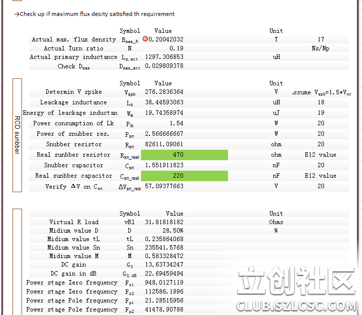

The following is a screenshot of my homemade flyback design gadget (due to various reasons and copyright reference issues, it is inconvenient to share the source file, please forgive me).
If you need to use the UCx845 automatic design tool, I recommend TI's Webench, which is also very convenient!
Input and output parameter settings:

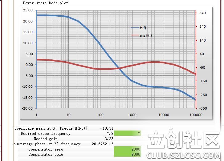

8EF088F917FB4576B44C0C7362B47FB5_735.png42FF00B723064E44A3F7A7ABBB9C3226_669.pngtransformer parameters (except for the incorrect air gap, other parameters are almost the same). There are actually some problems with the RC absorption circuit, which need to be corrected:
D501ADC4E04A4AFF89F17A57E6A12567_964.pngUse EXCEL to draw the power level Bode diagram

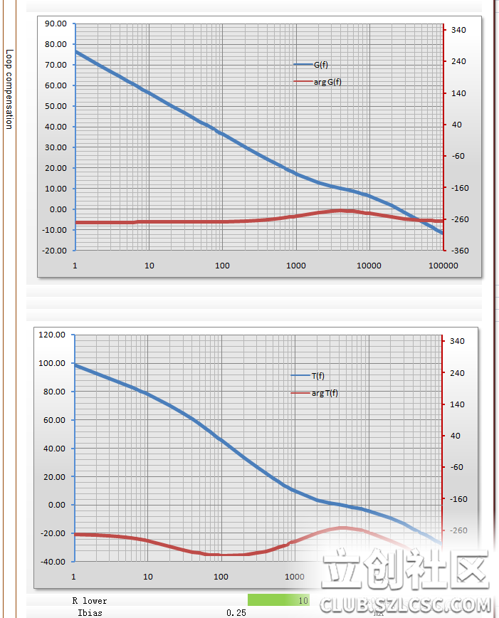

B9036B7D4A1545EF969E027D2277E3FB_693.pngto adjust the compensator, and the compensated Bode diagram (not yet fine-tuned):
Click to view full image I personally think that the switching power supply is three-point design and seven-point debugging. Although the work in the design stage must be done, there are actually quite a lot of variables, and more effort is needed for later debugging.

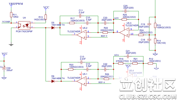

3. Voltage and current feedback loop:
5C0F19619E43434D8875EF769573794A_100.pngThis part of the circuit is my "Spring Breeze Power Supply" (I bow to my predecessor here!), and I have made some changes based on my understanding.
The upper part is the voltage loop, and the lower part is the current loop. The two parts drive the optocoupler after being "wired-OR" through the diode.
The structures of the two parts are actually the same. After the voltage and current are sampled, they first pass through the first-stage 0dB drive, and then output to the second-stage TYPEII compensator for compensation and optocoupler drive.
Not all capacitors in the figure are required, and the parameter values ​​are still to be refined and adjusted.
It is particularly important to note that the first-stage TYPE I capacitor and the subsequent TYPE II compensation should not exist at the same time. Otherwise, multiple poles will be superimposed (>-40dB attenuation)

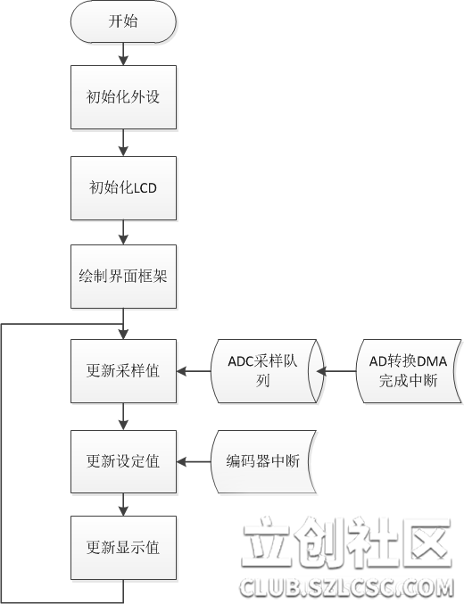

612807B0BCCD4F35BDCE3A776F304CC0_904.png   DCP3001_V01.rar (Downloads: 809)

When using PIExpert to design a transformer, the parameters were changed but not re-optimized, resulting in incorrect transformation ratio, high reflected voltage, and stuck for two days;
