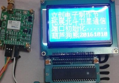

         In order to participate in the theme event designed by the Electronic Production Festival held by Lichuang Mall, a glimpse of the second version of the perpetual calendar PCB board with a 6-digit 4-inch digital tube static display for Beidou Satellite Time was exhibited, namely the Beidou Satellite UM220-Ⅲ N expansion port Board, the product is positioned as a communication control exercise for microcontroller beginners, and can be applied to model aircraft positioning, clock timing, navigation and other fields.
**       Beidou satellite UM220-Ⅲ N module is a domestic product made in China. Some outsiders claim that the positioning is not accurate enough. Currently, most users use the U.S. GPS satellite ublox module for timing and navigation. I went against the grain and decided to see it quickly, and expanded its port to 5V/3.3V power supply, 5V /3.3V level communication interface. **
**1. Introduction to the work (purpose, purpose and significance)
1 Practicality:     This expansion port board can be used for programming exercises for microcontroller beginners, aircraft model positioning, clock timing, navigation, etc. The expansion port board has a wide power supply range of 3.3~5V, and the communication port implements two TTL levels of 5V/3.3V, which can be directly connected to the microcontroller. At the same time, it can also learn the communication and data of different level microcontrollers such as I2C and SPI. transmission, program compilation, and then complete the required timing, positioning and other functions.

①** Power on / off control circuit**
主要控制北斗拓展板的启停,由**J1R3R5Q1组成,当gps_on处于高电平时,Q1截止,为U1中断供电,当gps_on处于低电平时,Q1饱和导通,为U1连续供电。该模式可由单片机远程控制或由J1**短路帽控制。 ②VCC**电源稳压3.3V及跳线电路 C1,C2,C3,C4,U1,J5组成,电容主要耦合,滤波消除电路的电磁干扰,J5主要用于供电电压3.3V时,短路帽短接以保证数据传输时指示灯供电的正常。 **电池充放电电路 由**R1,R2,R4,DZ1,DT1,DT2,BAT1组成,R1,R2分压后经DZ1稳压(这里DZ1也可不用),电流经肖特基二极管DT2R4BAT1充电,BAT1DT1放电至V_BCKP(其中外部电压和电池电压高者为V_BCKP供电),当外部电源断电,直接由BAT1DT1V_BCKP提供备用电源,保持BD1**芯片供电的连续性。 ④**复位电路 由常见的积分型复位电路组成,和AVR单片机复位电路类同。 **天线滤波电路 L1**防止天线的高频输入,造成电源的干扰,利用L1R14有效的解决了此类问题,最好在L1(标准68nh)R14之间增加2104电容,效果更好。 TXD2RXD2通信5V/3.3V输入输出转换电路 R11R12R18R19DZ2DZ3J3组成,R18R19起到限流作用,DZ2DZ3防止电压过冲,其中R11上拉电阻可以不用内部已经上拉 **其他 (I**2**C,SPI) 3.3V**通信接口,直接3.3V接口引出,未增加电平保护和转换,必须连接3.3V单片机。 TXD1RXD1通信5V/3.3V输入输出转换电路带通信指示灯 R15,RXD,Q4,R17构成接收转换电路,当输入RXD_IN为低电平时,RXD1为低电平,此时接收红色指示灯点亮,反之熄灭;R13,TXD,Q3,R16构成发送转换电路,当发送TXD1为低电平时,TXD1_OUT为低电平,此时发送蓝色指示灯点亮,反之熄灭。 通信BD1**芯片
和芯星通芯片比**UBLOX**信号灵敏度高,双模信号强,但外部可用端口少。
⑩PPS**信号指示灯及输出隔离电路**
由**R10PPSQ2R6组成, 信号正常时R10PPStimepluse输出绿色正常信号指示灯,其中PPSOUT端口由Q2**隔离,并供外部单片机使用,有效的隔离外部电压的影响。 11 **3.3V电源输出端子,VCC输入3.3V时,需短路帽短接gpsin否则传输信号指示灯无法工作**

8、作品演示(扩展选项,可不写) 应用图片及视频链接示例:  8.1附自制万年历校时图片
视频链接:http://v.youku.com/v_show/id_XMTc2MDM4ODM2MA==.html 8.2电脑接收通信实例图片 8.3单片机通信12864显示实例图片 视频链接:http://v.youku.com/v_show/id_XMTc2MDM3NjE0MA==.htm
