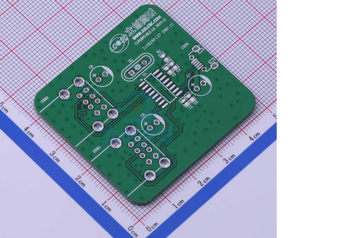

C479658_SL2.1A USB hub solution verification board
This solution is a solution verification board suitable for the USB hub main control chip model SL2.1A. The chip has a power supply voltage of 5V and an internal integrated 5V converter to 3.3V. The chip has a built-in 12M crystal oscillator. You can choose the use of internal or external crystal oscillator by adjusting the R1 0R resistor on the schematic diagram according to the actual usage.
