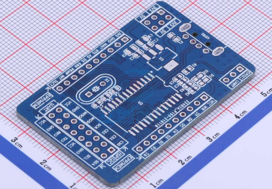

The design uses the USB male connector as the input, and uses two jumper caps to select whether the chip supply voltage is 3.3V or 5V. Lead out SPI, IIC, UART, EPP/MEM and other interfaces through pin headers.

After the driver is successfully installed, we use a jumper cap to connect the mode selection to the ISP/I2C position.
The power selection jumper cap allows you to choose 3.3V or 5V. Plug the board into the USB interface and connect it to the computer.
At this time, the blue light on the board lights up, as shown in the picture above.
