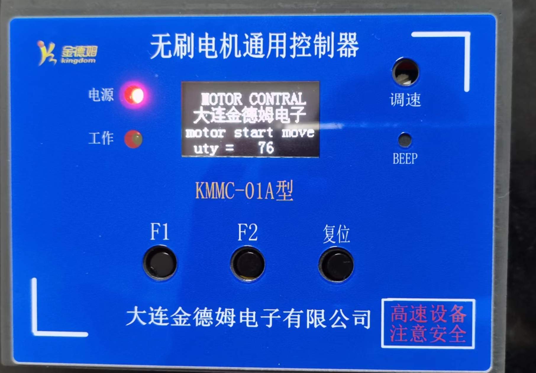

The basic consideration of this project consists of two parts. First, the basic brushless motor controller. Secondly, the LED advertising kit constitutes a complete brushless motor advertising display device.
1. Hardware introduction:
The processor of the hardware part uses a 32-bit processor. Through the analysis of the project, the circuit board is divided into two parts. That is, the CPU board and the control acquisition power supply board.
The lower circuit board is divided into three parts, power supply, acquisition and control
At the same time, the original 34PIN terminal block is divided into 8pin control and 18pin acquisition, and separated. This function is clear and facilitates EMI isolation design.
2. Software introduction
In the software part of this design, the core of the design is the 6-step inductive commutation operation of the DC motor, but it involves a variety of software functions such as: PWM, capture, AD, etc. The specific software flow chart is as follows:
3. SCH drawings. see engineering
4. PCB drawings. see engineering
5. Software process
6. Function operation
Function key F1, function key F2, reset key and speed regulating rotary potentiometer.
