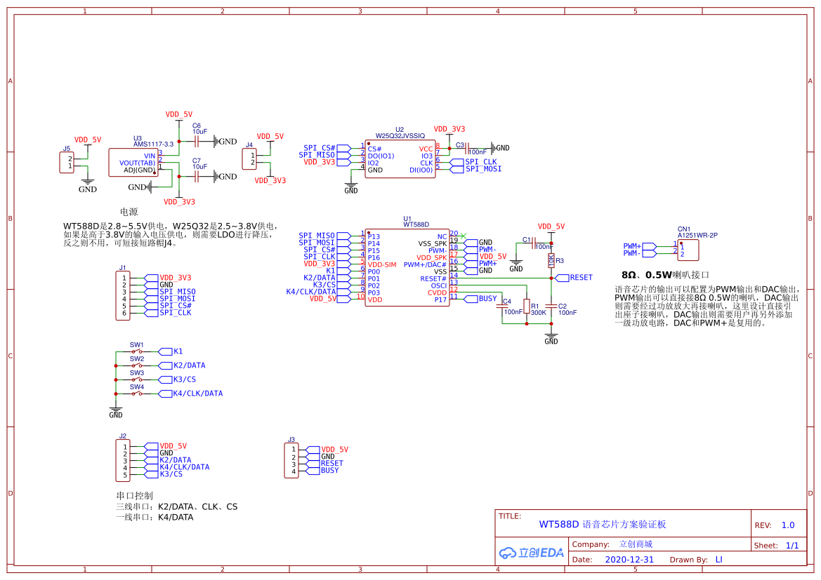

WT588D voice chip is a powerful repeatable erasable and programmable voice microcontroller chip. WT588D allows voice chips to no longer look for suitable peripheral microcontroller circuits for control methods. The highly integrated microcontroller technology is sufficient to replace complex peripheral control circuits. . With the WT588D VoiceChip host computer operating software, you can freely change any control mode and voice content of the WT588D voice microcontroller chip, and download the information to SPI-Flash. The software operation method is simple and easy to understand, and it combines voice combination technology to greatly reduce the time of voice editing.
WT588D has several package models, some have internal integrated SPI-Flash, and some require external SPI-Flash. Our solution verification board uses the one that requires external SPI-Flash. The advantage of SPI-Flash is that you can choose different sizes of Flash. chip. So we also integrated a W25Q32 classic 32M Flash chip on the board. The welded finished product is shown in the picture below.

Then compile and generate a BIN file. Then we can convert the BIN file to Flash through USB to ISP module. Note here that when burning, use a jumper cap to short-circuit the reset pin of W588D to ground to put WT588D in reset state. In my actual test , if you do not reset the WT588D, the programming will be unsuccessful. At this time, when we power on and press button 1, we can play the voice in address 000.
