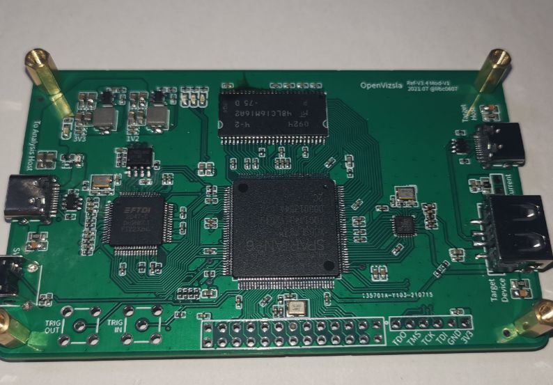

Low cost USB analyzer V1 compatible with OpenVizsla V3.4
Introduction
USB protocol analyzer, the schematic diagram refers to OpenVizsla Hardware Design V3.4
  • PCB process parameters support Baijia Lichuang (four layers, 6cm * 10cm)
  • Components are maximally compatible with Jialichuang SMT basic library
  • Single-sided patch, only a small amount of soldering required
Don’t ask why I didn’t build Luna. I didn’t see that project until the board was sent out ()
OpenVizsla original project address: https://github.com/openvizsla/ov_ftdi
