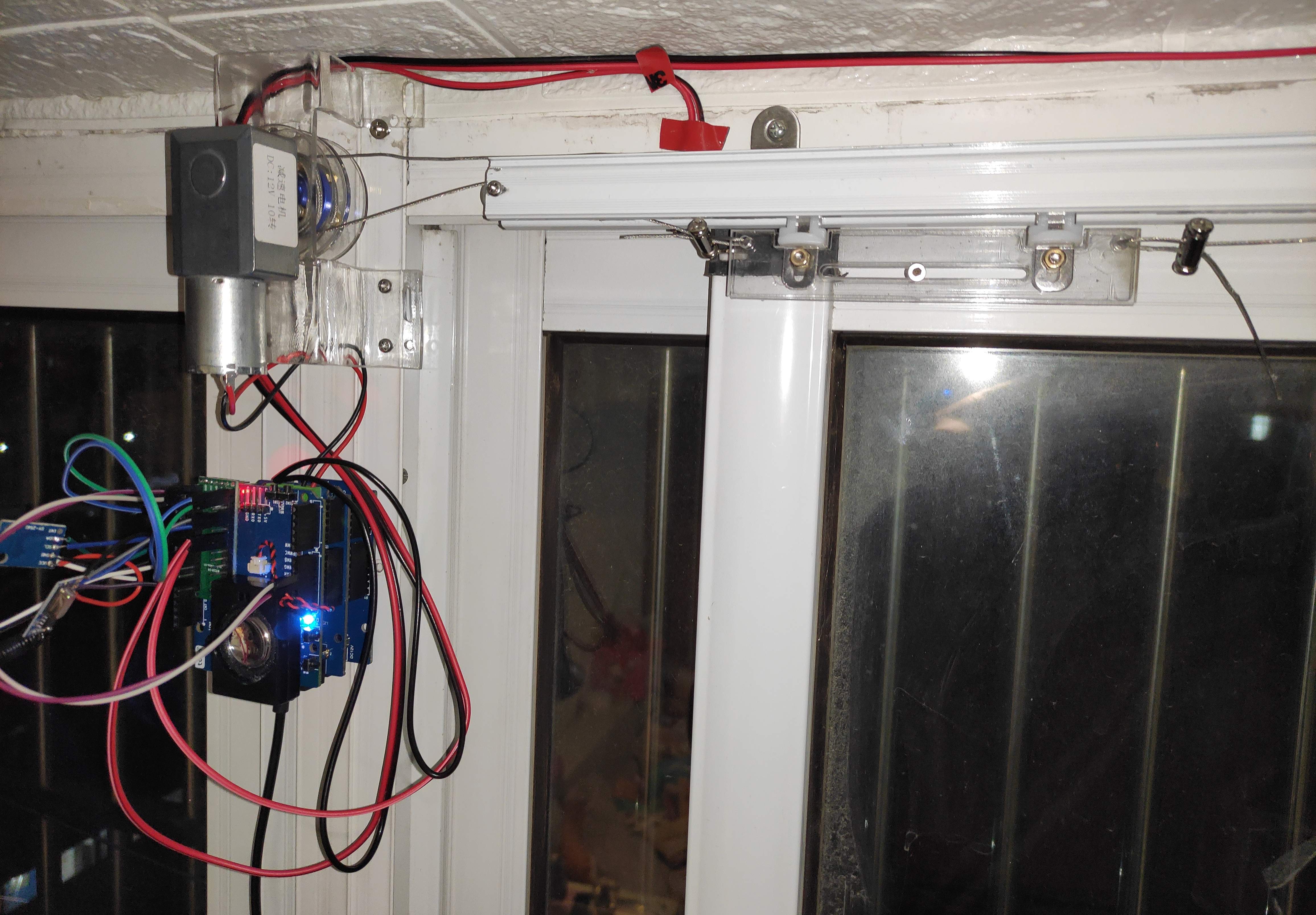

The opening and closing of the windows at home is indeed a pain point. You must open the windows for ventilation before going out in the morning. If it rains during work, you will really feel uneasy until you get off work. I also noticed that smart horizontal window openers have appeared on the Internet, but 1.5 meters basically costs more than 300 yuan, and they all use direct plug-in power supplies. There is no such window power supply reserved at home, so it is extremely inconvenient to modify! I had the idea of DIYing a smart window opener early on. Tuya’s pet feeder event happened to use a motor driver board, so I gave it a try!
1) The customized acrylic base plate is fixedly connected to the window frame with screws. Later, we will consider using a customized aluminum alloy frame to make it lighter and stronger.
2) The JGY370 reduction motor + bracket is fixed on the acrylic base plate.
3) Tuya sandwich motherboard and motor board are fixed on the acrylic base plate.
4) Temporarily use the mobile power supply as a power source to power the motherboard and motor.
5) The JGY370 reduction motor is connected to the rails with a steel wire rope, which is low cost and the steel wire rope is relatively tight.
6) The slider is softly connected with the window to be opened and closed using a screw, so that after the window is closed, it can be manually moved in a short distance to realize the detection of manual window opening!
7) After the subsequent prototype is successful, consider using EDA to draw the circuit board to realize power supply from two 18650 or 26650 batteries and add a charging circuit!

1. Paper mold making and track production (the track cost is about 15 yuan per meter, I only used 75CM)
2. Make holes for the track and install the pulleys (I am a bit ugly because I am handicapped!!) The cost of the pulleys is about 1 yuan plus postage.
The cost of the motor is about 25 yuan. The 370 motor is too slow at 10 rpm. After the mechanical test is normal, it will be replaced with a 90 rpm motor!
3. According to the PCB diagram, laser-engraved acrylic (the round one requires three pieces to assemble, and the long strip connection for the bottom track requires two pieces, and it is engraved again later!!)
4.Track installation
5. Track and window connection
6. My hot-bent acrylic frame is really unbearable and one side is broken. Let’s make do with it. I still need to find a solution for the latter part.
7. The protagonist enters: Tuya Sandwich development board family portrait, left: DC power board, middle: H-bridge motor board, right: voice communication board
Connect the motor to the H-bridge motor board
8. The second protagonist, LGT328P development board, compatible with Arduino, costs about 5 yuan
MCU and sensor family portrait, left: light sensor, right: 433 receiving module
Connection, the 433 module uses the D2 pin of the development board, and the light sensor uses I2C, A4, and A5 pins
9. Development configuration using Arduino IDE
10. Use Tuya debugging assistant to test the SDK transplantation and OK!
11.MCU and voice communication board online test OK
12. Go to the window, install and debug
