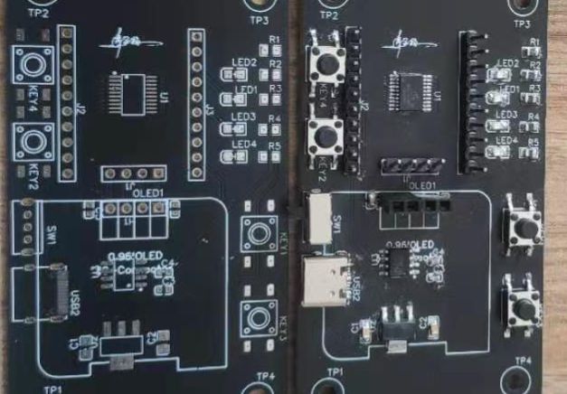

Hangshun MCU HK32F030 minimum system development board
Hangshun MCU HK32F030 minimum system development board development record
Let’s take a look at the schematic diagram of the drawn circuit board. I really don’t know how to draw a board, so I just drew it blindly. The drawings on the board have no reference value!

I gave Chuangxin Workshop a PowerWriter here, so I used it to study it. Now I’ll talk about the process.
The example of the wiring of the downloader to the chip is given in the core creation workshop as shown in the figure 7fec5e6aab389d5dd85c9772ab66f34.png
My wiring is: a4ad8e0c21b566166e5bfcaa0a99450.png First, go to the official website of Innovation Workshop to download the software and give the address: https://www.icworkshop.com/user/btDetails/pw/7 After the installation is complete, open the software as shown in the figure, 7166437ff2bfbeee4c4580d1651504c.png click to select the chip b395013cf87bdb4b10b33417d836a21.png , and then click Apply a74b72309dc22b31a24d2cc7b1794b3.png to connect. Come down and add our hex file. ce5e79aad8e1898a7fb5fdfeec91b49.pngc9367380fa2e17cedb5a27a3d4f0235.png3c608386b94e44acd0694682f94103d.png050acbaaff60da8b14b27f9d6603ded.png4fd38469e6d5c06d27b6adf1069dd87.png11c984dd6a1939d2824481b2d08a823.png Adding the file here is done. Next we start burning.
If all goes well, your LED light should be buzzing ! ! ! ! ! !
