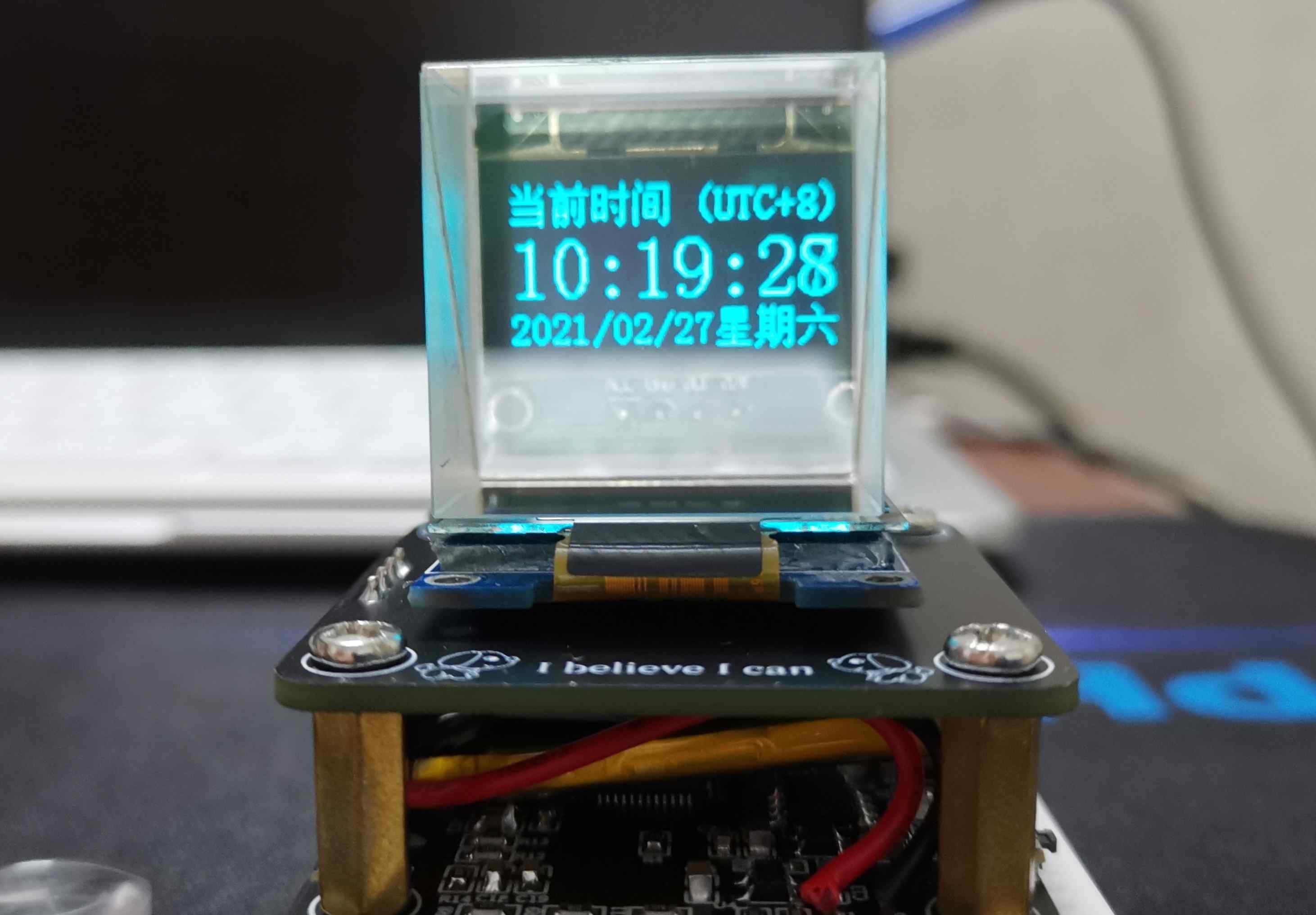

hardware design
Please refer to the project schematic diagram for the specific circuit.
  • The control chip uses STM32F103C8T6 because I am most familiar with this chip.
  • It is powered by a lithium battery and can be charged through the typec interface.
  • There is a CH340N chip onboard, which can communicate with the computer via serial port for easy debugging.
  • Two ME6212C33 chips are used for voltage stabilization, one of which supplies power to the MCU alone and the other to other peripherals. This is beneficial to the stability of the circuit, and can also be used to disconnect the power supply of other peripherals through MCU control, thereby saving power.
  • The networking module uses the "WB3S-IPEX WiFi&BLE dual protocol module" officially recommended by this event, which has wifi and Bluetooth functions. In order to prevent the heat of the module from affecting the temperature measurement, and also to avoid interference to the module's signal, I placed the module on another board, and the two boards were connected through pin headers and female headers. Tuya module adapter board open source link: https://lceda.cn/linkk/zhi-neng-wen-shi-du-chuan-gan-qi_-tu-ya-kuo-zhan-ban
  • The temperature and humidity sensor uses the commonly used SHT30, and grooves are carried out around it to minimize the interference of the board temperature on the SHT30. However, the temperature measured in actual use will still be a little higher than the real temperature.
  • Displayed through OLED screen.
  • There are two buttons and three LEDs on board.
  • Although equipped with so much hardware, the size of the board is only 40mm X 40mm, which is very compact.
