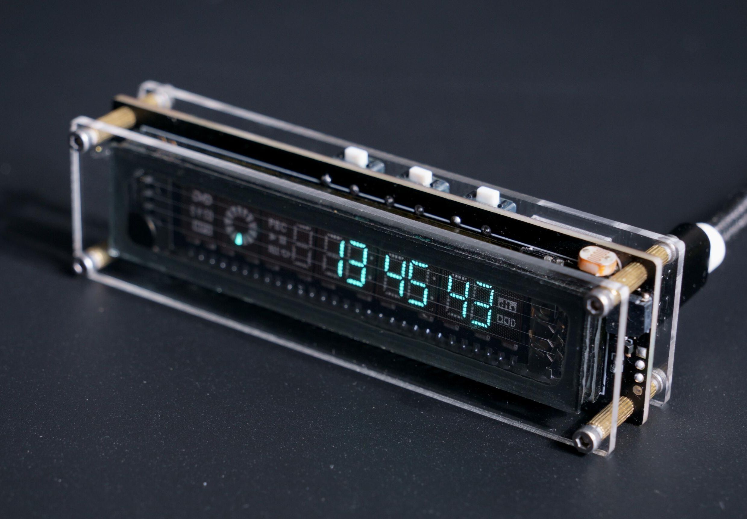

Negative voltage circuit + LM9022 AC filament driver + HT16512 constitute the drive circuit of this VFD screen. The pin diagram shows the segment information and the corresponding display data written into HT16512.
Program download: Please understand the use of STC-ISP by yourself.
Assembly: The VFD screen is fixed on the PCB with 3M double-sided tape, single-pass copper pillars M2-5+3mm x4 on the rear panel, double-pass copper pillars M2-8mm x4 on the front panel, M2 round head hexagon screws x8, two cut 1.8mm thick acrylic plates (the cutting specification file is in the front and back panels of the circuit project, please export it to Taobao to cut it yourself)
