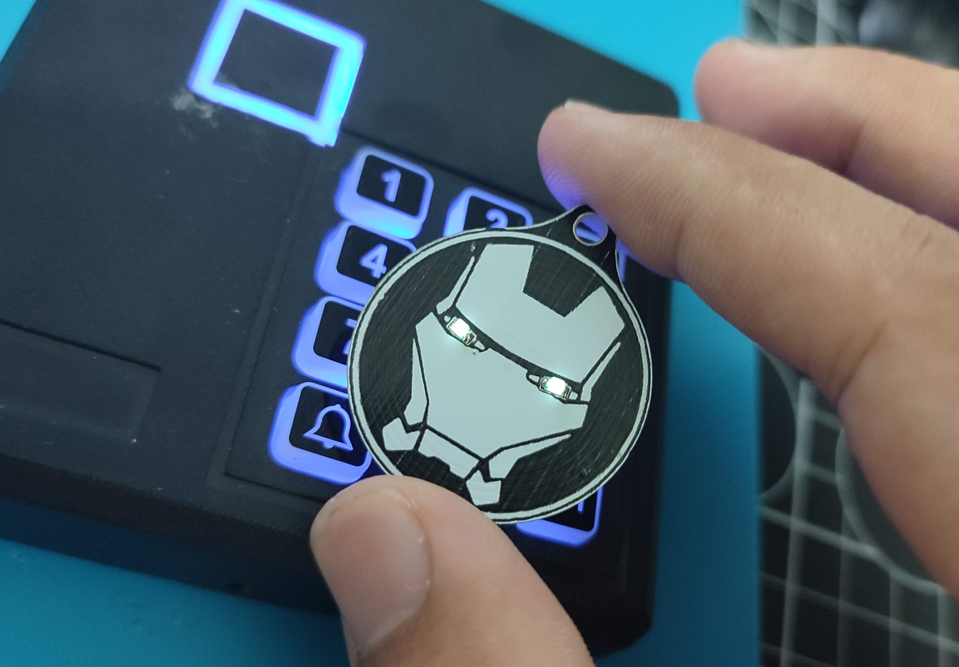

1. The working principle is simple. It uses the current induced when swiping the card to power the chip and LED at the same time.
2. The LED and the chip are connected in parallel, and the LED package is 0603.
3. The chip has no positive and negative poles, so you can just solder them casually. Currently, it only supports IC cards .
4. How to distinguish between IC card and ID card
5. Pay attention to the front and back of the LED. Soldering it backwards will affect the normal operation of the chip.
6. Use 0603 100Ω as the current limiting resistor. You can also use 0603 switching diode instead of the resistor for better effect (pay attention to the positive and negative poles).

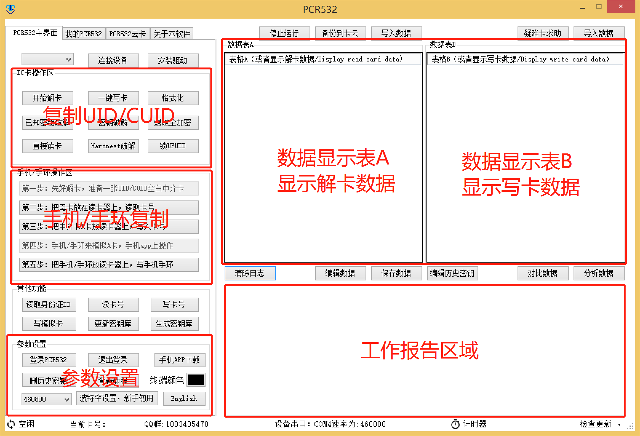

8. If you want to copy the access control card, you need to use the IC card reading and writing module and supporting software. You can use PN532 or PCR532 (PN532 needs to be used with a USB to TTL module, and novices should use it with caution).
Exclusive benefits for PCR532 module fans (the boss said the lowest price, single board + OTG transfer + CUID copy card + mobile software VIP + 7 days no reason + freight insurance) = 39 yuan
Link : https://m.tb.cn/h.fgq8Wj2
Taobao password: 9$gAz1XEnWAwz$://
The supporting software for the PCR532 module has both a mobile phone version and a computer version. The computer version can be used directly for free. The mobile version requires a VIP member. This order does not include VIP. I need to mention my Douyin account name to the boss before I will send the VIP. It is recommended. After receiving the goods, try it out on the computer first. If you think it's OK, it's not too late to get the VIP to avoid returning the product after getting the VIP for free. If customer service doesn't deliver, you can send me a private message and ask, and I'll go find the boss. (In addition to VIP, there is also super VIP. If you have money, you can spend another 40 to buy super VIP. However, I personally feel that the super VIP function is not very useful. Non-professionals recommend spending calmly).
9. Download the computer and mobile software in the attachment of this article or click the link below to download.
Software download link: http://www.rfidfans.com/thread/9
Some computers may not have the ch340 serial port driver and cannot connect to the device. I have put the driver installation package and installation method in the project attachment file. Unzip it and use it.
VIP is not required for the computer version, but is required for the mobile version.
