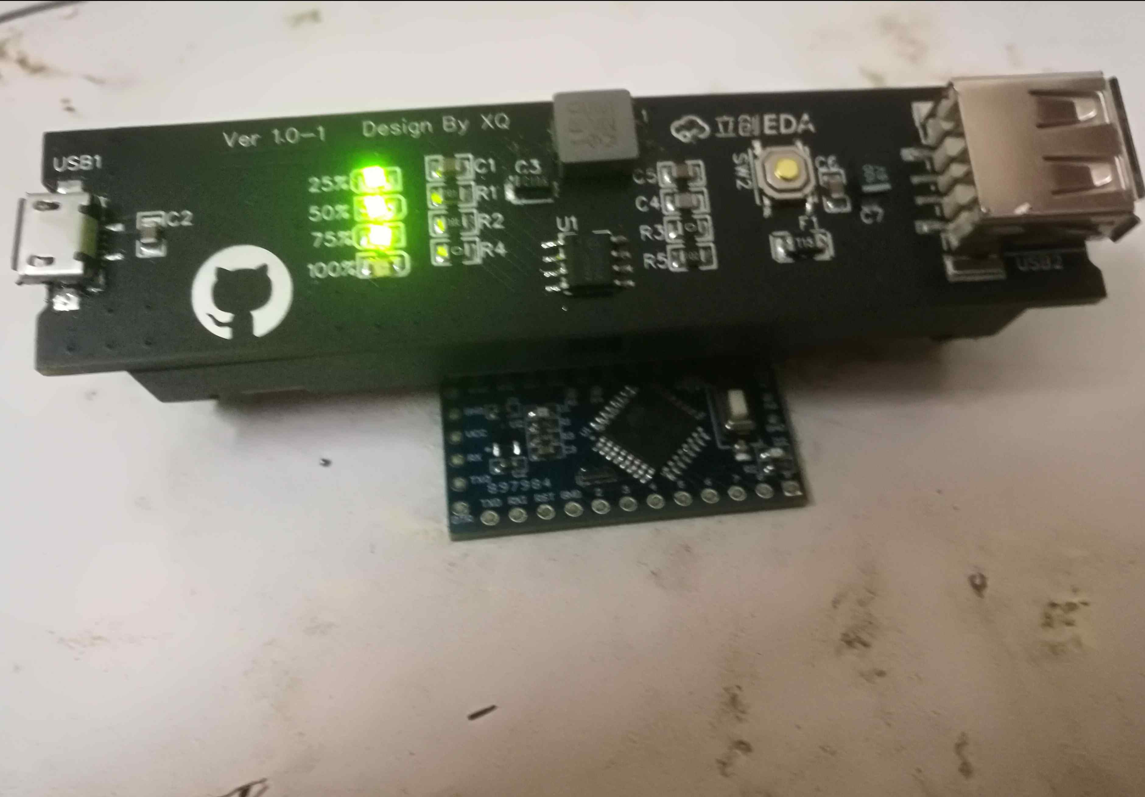

[Successful test] 3.7V boost 5V power bank circuit based on IP5306
Referenced from https://oshwhub.com/Qmery/IP5307shuang-lu-2.1Achong-dian-3 and IP5306 Datasheet (see attachment)
  1. 2.4A synchronous boost conversion, 2.1A synchronous switch charging
  2. Boost efficiency up to 92%
  3. Charging efficiency up to 91%
  4. Built-in power path management, supports charging and discharging at the same time
  5. Adaptive charging current adjustment, adaptive adapter
  6. Support 4.20/4.30/4.35/4.40V battery
  7. Support 4 LED power display
  8. Button to power on
  9. Built-in lighting driver
  10. Automatically detect phone insertion and removal
  11. Intelligently identifies the load and automatically enters standby
  12. Standby power consumption is less than 100 µA
  13. Built-in power MOS, single inductor realizes charging and discharging
  14. Output overcurrent, overvoltage, short circuit protection
  15. Input overvoltage, overcharge, overdischarge, overcurrent discharge protection
  16. Machine over-temperature protection
  17. ESD 4KV, instantaneous withstand voltage 12V (the above information is copied from Datasheet)
That battery has been discharged...
QQ picture 20200406064534.jpgQQ picture 20200406064538.jpgQQ picture 20200406064541.jpg
