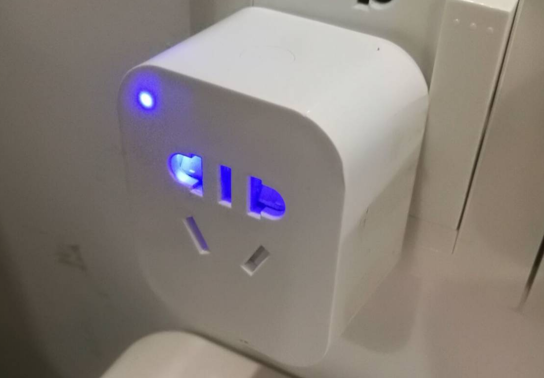

Due to personal reasons, I mistakenly placed the S8550 transistor at the lower end of the relay and did not discover the problem in time, resulting in the equipment not working properly. I deeply apologize for this and am currently correcting it.
During the initial test, I also encountered the problem of the relay closing but the LED not lighting up. I initially thought the triode was burned out, but the problem was not solved after replacing the triode. When the B pole is at a low level, the voltage of the C pole of the transistor is measured to be about 3.8V, so R3 is changed to a 0Ω resistor, and the LED positive pole is flying to 5V. The function is normal. I mistakenly thought that the test had been successful and released it without realizing the problem. location

I feel that the previous version 5.3 WiFi smart switch is not very practical and can only be installed in an 86 junction box. Moreover, for some novices, it is risky to modify the home circuit. So I plan to build a WiFi smart socket, which eliminates the need for wiring and is safer.

Function
  1. Local button, cloud, voice assistant control device
  2. Mobile phone distribution network, network information will not be written down
Instructions
  1. Power on: Plug the device into the socket and wait for the device to connect to the Internet
  2. Switch: Press the "Turn on the lights", "Turn off the lights", "Click me to turn on the lights" button on the cloud, call Xiao Ai to turn on the lights, and short press the button on the top of the device
  3. Pressing the "delay opening and closing" button on the cloud or long pressing the button on the top of the device will allow the device to delay opening and closing the circuit after 12 minutes (obsolete)
