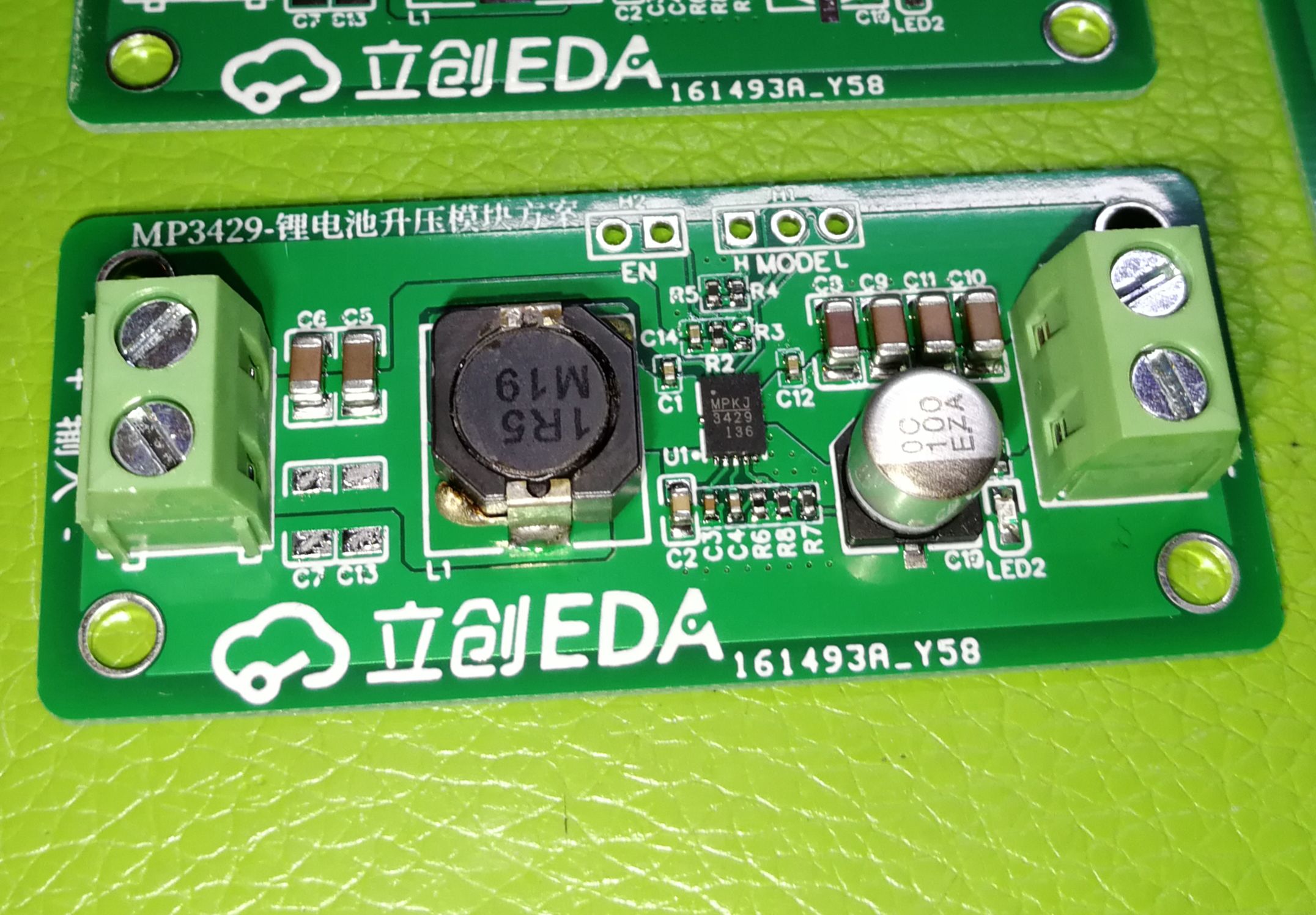

Chip solution DC-DC chip MP3429GL-Z
The input and output of this solution are all in terminal mode.
Input voltage: 2.7V-13V
Output voltage: up to 16V (default setting 9V)
Output current: 3A
Output power: no more than 30W
Switching frequency: 600KHz
EN interface short circuit closes the module
Test: 6v to 9.3v2A efficiency 93%, 3A efficiency 91%
MP3429 is a highly integrated, wide input voltage, 600KHz fixed operating frequency boost chip.
Its minimum input voltage is as low as 2.7V.
Thanks to the built-in low-resistance power MOSFET, the output power can reach 30W when powered by a single lithium battery.
The PSM/FCCM/USM working state at low load can be selected through the mode pin.
The low-side MOSFET has cycle-by-cycle current limiting to avoid runaway current, and the high-side MOSFET no longer requires an external Schottky diode.
