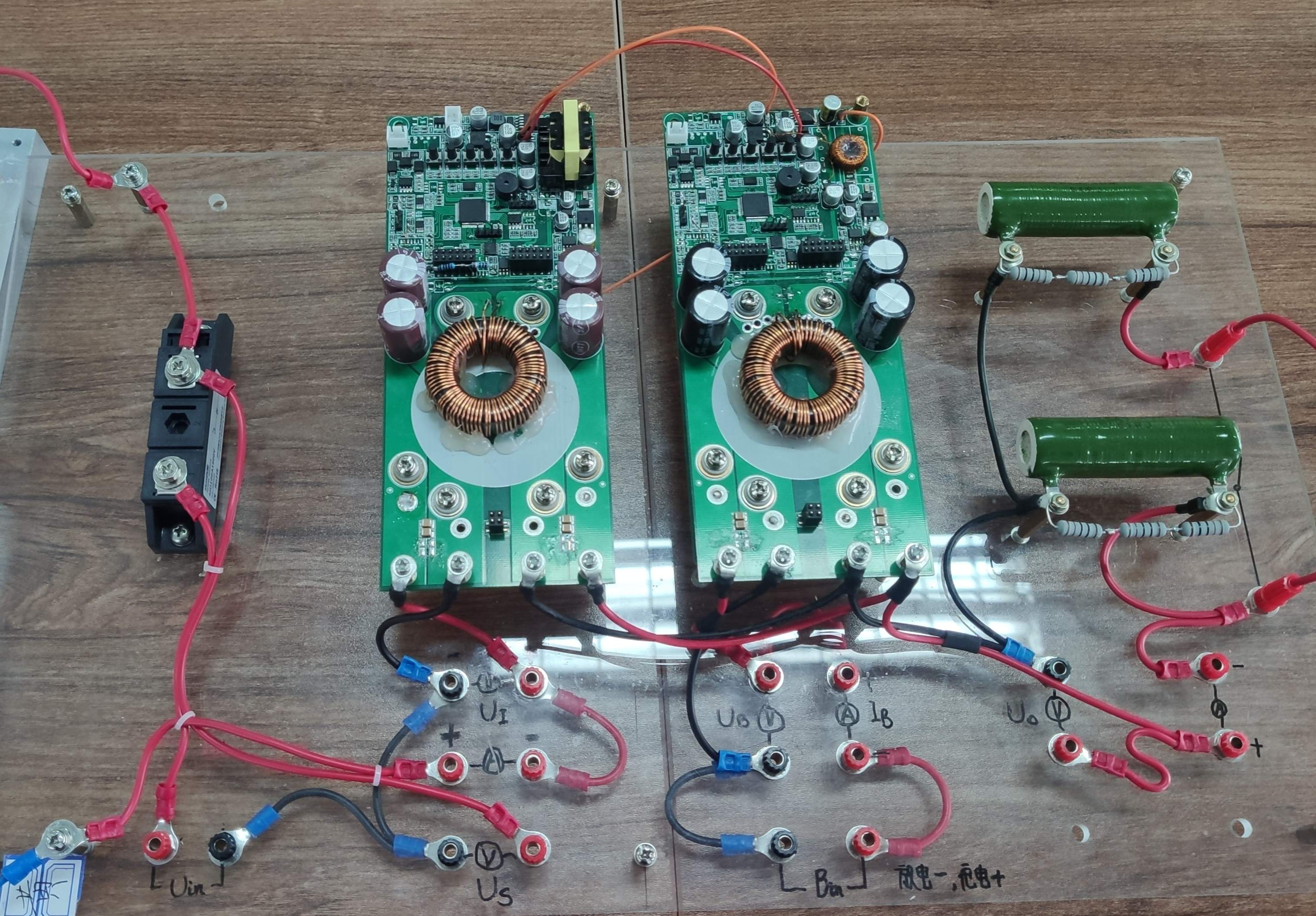

diode that meets the requirements. MOS tube drive circuit design Bidirectional DCDC design: Because this thing came out 15 years ago, I personally think it is a pretty good blog, and we have learned a lot. Link: https://blog.csdn.net/weixin_42121843/article/details /99288773So students who prepare power supply will basically make a set of bidirectional DCDC. Our simplified diagram: Current detection design: Voltage detection design: Auxiliary power supply design: At this point, all our circuits are completed: BOOST boost, bidirectional DCDC, ADC Voltage and current collection, two minimum systems of 32, one for boosting and one for bidirectional DCDC. (In fact, the boost is also modified using two-way). 5: System control: According to the diagram above, we collect data first after powering on. If there is an abnormality, it will enter the fault state, directly perform audible and visual alarms and stop outputting PWM. If there is no abnormality, our boost MPPT will start to boost the voltage. When the output voltage is higher than 31V, we will compare Uo with the set value and send it to pid for voltage stabilization. Then when the voltage drops and does not reach 31V, we perform MPPT maximum power tracking. In this way, we directly achieve full-range maximum power tracking. The program is written according to the diagram above. The core program is as follows: This core actually also adjusts the pid. This is true for the two major modules of the system, one boost and one bidirectional. The rest is collected by the ADC. 6: Test adjustment:        When testing, we need to connect the battery first, because the voltage we initially connected is 50V. If there is no battery for charging (it must be in mode 1 at this time, if you don’t understand, you can read the analysis at the beginning), Then we can't stabilize the voltage. Why connect 50V at the beginning? Because our auxiliary power needs to work first.        During the test, the battery will be fully charged. At this time, the system will be unstable and very unstable. At this time, just switch the mode to mode 2, which is the discharge state, and the input voltage can be adjusted to 25V. , at this time the discharge current should be around 1.5A. This test was the result of the final debugging at that time. The efficiency of the two core parts was just over 95. Because two CPUs were used, there were some shortcomings, so this data seemed quite good. Test video of station B: https://www.bilibili.com/video/BV1ma411r7qa/

In the physical display,
the main control we use is STMF103VCT6. MOS, MOS driver, current and voltage acquisition, etc. are all written on it. These things are available on Lichuang Mall. We also bought a lot of things on it when we were preparing for the competition. Our test points are marked on the acrylic board. We used a total of 7 multimeters. These test points are all based on the requirements of the questions. There is a sticker at the beginning.
